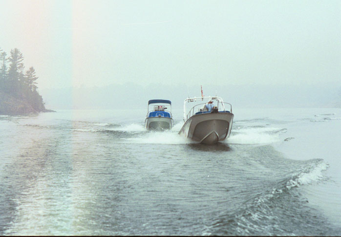

Into the Mists
The gorge passage up Collins Inlet had just enough visibility to run at speed. We are approaching noon but still in mist. Classic Whaler hull design in evidence here. Technical note: compare the relative size of 19 and 25 foot hulls.

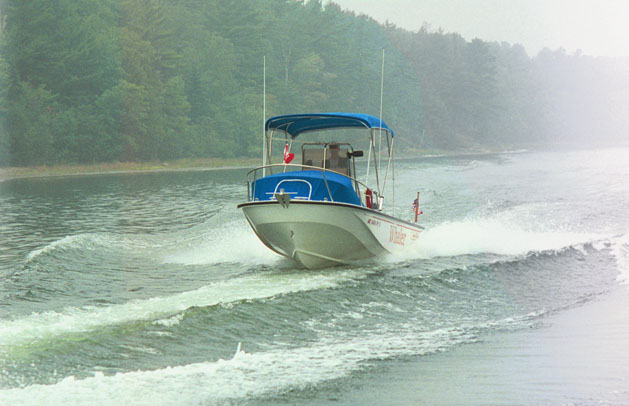

In a Fog
Cruising up the dead calm water of Collins Inlet in a lifting fog, our Whalers make a pretty picture. A few miles ahead things are about to turn sour.

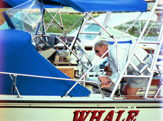

Canvas Rigging
The forward shelter on the 25-Outrage rigs quickly thanks to a great design by canvas maker Wm. J. Mills & Co. Here Larry Goltz tensions the drawstring that secures the frame to a small cleat on the gunwale.
