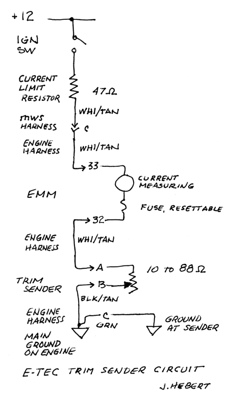

Below is a sketch that shows the E-TEC legacy engine TRIM SENDER circuit with some detail.
Legacy E-TEC engine trim sender circuit.
Circuit Description
Current from outside the EMM, typically from the boat cranking battery is switched on at the ignition key switch at the helm. The current is limited by a series resistor in the wiring harness or if an actual TRIM gauge is installed by the circuitry of the gauge, not shown in the sketch.
The current is carried back to the engine on the remote control wiring harness (MWS Harness) and loops through the EMM. In the EMM a current measuring device measures the current. The current will be proportional to engine trim (explained below). Also in the EMM a resettable thermal fuse or circuit breaker protects the EMM circuity from excess current flow.
Current leaves the EMM and is carried on the engine wiring harness to the trim sender. In the trim sender a rheostat with resistance range 10 to 88-Ohms is linked mechnically to the engine mount so that the engine position actuates a lever that moves the rheostat wiper connection. This changes the total resistance in the circuit and alters the current flow to be proportional to engine position.
The trim sender resistance will be near 10-Ohms when the engine is fully up and near 88-Ohms when the engine is fully down. We can estimate the current flow in the circuit as follows:
AT FULL DOWN
The total resistance will be 47 + 88 = 135-Ohms. With 12-Volts applied the current will be 0.088-Amperes
AT FULL UP
The total resistance will be 47 + 10 = 57-Ohms. With 12-Volts applied the current will be 0.21-Amperes
This change in current is measured in the EMM by some method, and from the measured current the EMM develops a digital signal of 0 to 100 representing engine trim position. The EMM can also be adjusted (using the EV-Diagnostics software) to calibrate the conversion of current to the digital signal representation so that only a portion of the total range of resistance is used, as will occur when there are mechanical and electro-mechanical limits that constrain the engine movement to a smaller range.

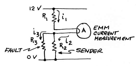

Re: Fault Current
Postby jimh » Tue May 08, 2018 9:47 am
If we assume a fault occurs somewhere in the trim sender circuit in which some current leaks to ground, the location of the fault affects whether the fault current is passing through the EMM, where it could cause the resettable fuse to open. If the fault occurs upstream of the EMM, the fault current does not pass through the EMM current measurement device. This is illustrated below.
R1 = current limiting resistor, nominally 47-Ohms
R2 = trim sender resistor, nominally 10 to 88-Ohms
R1 = abnormal fault resistance to ground; possibly very low resistance
Current flow in trim sender circuit. In this instance, fault current does not pass through the EMM current measurement sensor.
Current i1 = total current
Current i2 = the normal current passing through the EMM and the trim sender
Current i3 = current flowing in a fault to ground. The EMM only measures current i2
If the fault is downstream from the EMM, then the fault current passes through the EMM and is measured there, affecting the resettable fuse protection. This is illustrated below:
Current flow in trim sender circuit. In this instance, fault current does pass through the EMM current measurement sensor.
Current i1 = total current, in this case passing through the EMM and being measured
Current i2 = the current in the trim sender
Current i3 = fault current flowing in a fault to ground.
