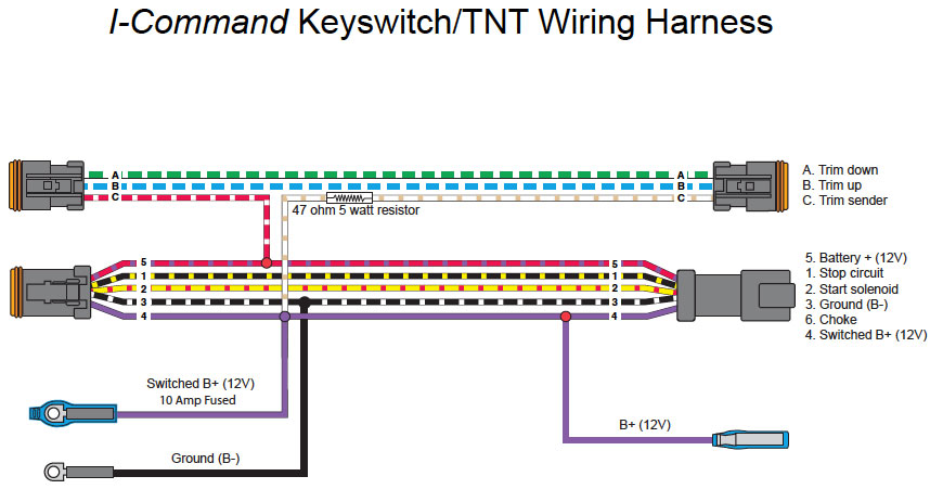

The stock Evinrude I-COMMAND WIRING HARNESS looks like this:
Fig. 1. Evinrude I-Command Wiring Harness; from the service manual.

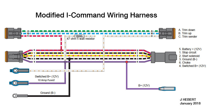

Note that there is embedded in the harness at some point a 47-Ohm 5-Watt resistor. To modify the harness, the resistor must be located. Typically the resistor can be found by careful visual and tactile examination of the cable. Once the resistor is located, it must be cut out of the circuit. The TRIM SENSOR circuit must be extended with a new conductor and fitted with a ring terminal conductor. The modified cable will look like this:
Fig. 2. Modified I-Command Wiring Harness to break out the TRIM SENSOR circuit
Note that you can leave the 47-Ohm resistor connected to the VIOLET (Switched 12-Volt Accy) circuit, but carefully insulate the free end. It will be difficult to get new wire with WHITE-with-TAN-Stripe color insulation; just use wire with WHITE insulation and mark the conductor with some brown tape cut into small stripes near the ring terminal end.
A conventional trim gauge can now be connected to the modified cable. The new conductor you added goes to the S terminal post; the exiting BLACK conductor with ring terminal goes to the G terminal post; the exiting VIOLET conductor with ring terminal goes to the I (ignition key) terminal post.

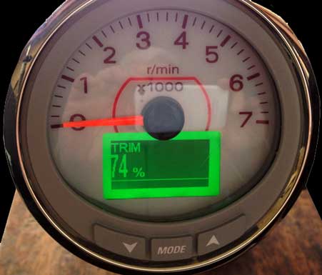

A boater has connected the trim sender of his E-TEC 90 to an ICON Pro RPM gauge and configured the RPM gauge to get input for TRIM from an analogue input as described above. The trim data is displayed on the RPM gauge LCD display, as expected, and, quite surprisingly, a dedicated ICON Accessory two-inch gauge for TRIM also shows the engine trim.

ICON Pro RPM gauge LCD display shows trim value.

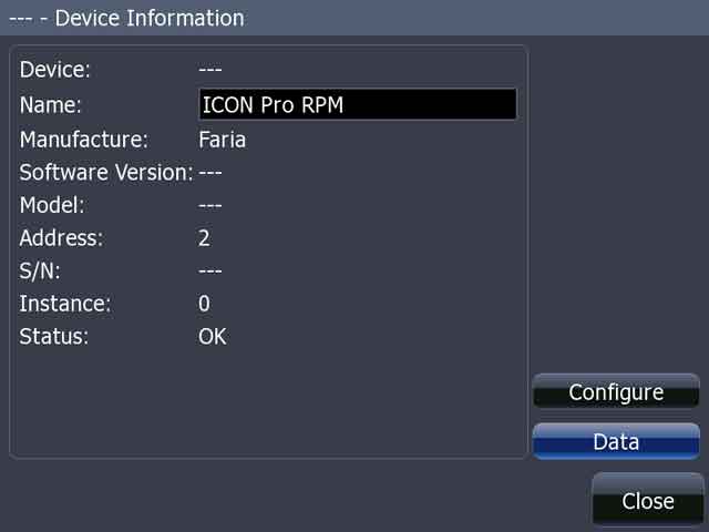

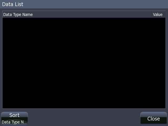

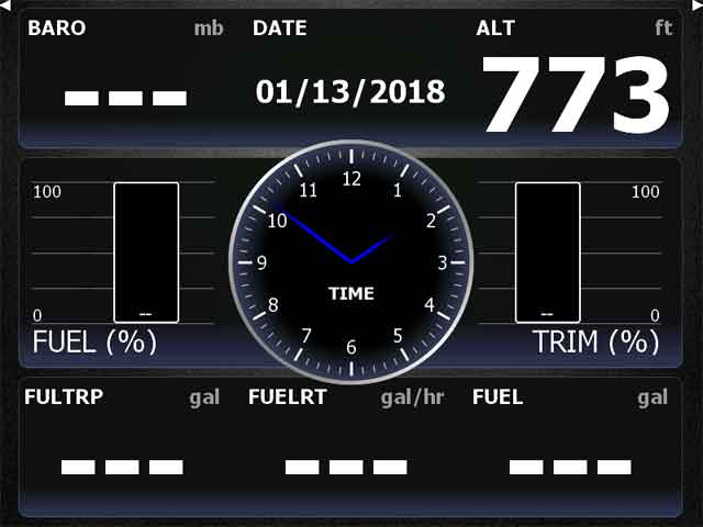

Confident that I had properly set up the ICON Pro RPM gauge to read engine trim data via its analogue input, I then connected the ICON Pro RPM gauge to the bench's NMEA-2000 network. Also on the network was a Lowrance HDS-8 multifunction display.
On the HDS-8 multifunction display, a page was already available to show engine trim data, having been set up to read it from my E-TEC engine. As expected, the trim data from the ICON Pro RPM gauge did not appear. This was expected, for two reasons:
    --the HDS was set up to get its engine data from the E-TEC engine on my boat, and that engine was not on the network;
    --the HDS did find the ICON Pro RPM gauge on the network, but it saw NO DATA coming from the gauge.
The HDS multi-function display showing no trim data on the engine data page.
The HDS multi-function display sees the device called ICON Pro RPM gauge on the network.
The HDS multi-function display showing no data coming from the ICON Pro device in the network diagnostic screen.
