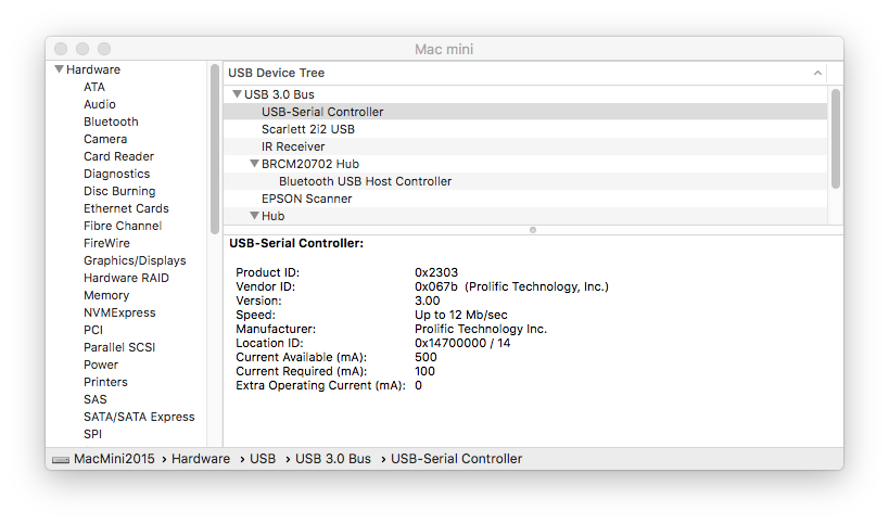

Checking for Installation
To verify you have installed the driver and it's the proper version, plug in the BU-353 to a USB port, then run the System Report (under "About this Mac" under Apple Menu). You should find the driver as shown below:
Fig. 1. From "System Report" output, the Prolific driver is shown.
