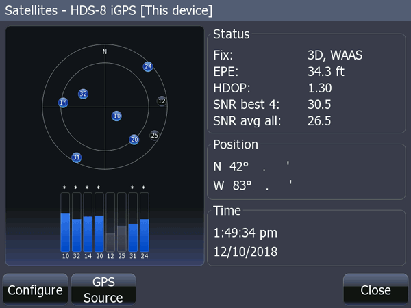

As a random data point, my first-generation Lowrance HDS-8 continues at present to show the proper time and date. And my GlobaSAT BU-353 USB GPS receiver is sending a NMEA-0183 output with the correct date and time at this moment.
Fig. 1. Screen capture from HDS-8 first generation showing display of proper time and date, thus immunity to the GPS Week Epoch changing to four digits in decimal, as occurred in October, 2018. Note I have obscured the location of the receiver in this image, but the position finding of this receiver is also working properly.
