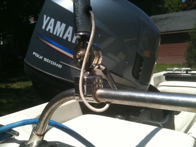

My Outrage 17 I came with an 8' antenna mounted on the gunwale (side of boat) amidships. Terrible. Everyone grabbed it while boarding. I moved it the the aft rail on a ratcheting mount.
I would mount it on the rear most riser, rotated outboard slightly, of the rear rail so that it will lay flat between the rail and the hull.
Here is the mounting from my Outrage 17 I. I would use the same mount. It is a Shakespeare rail mount in stainless steel. I don't recommend the cheaper nylon version, it broke the first month I had it.
