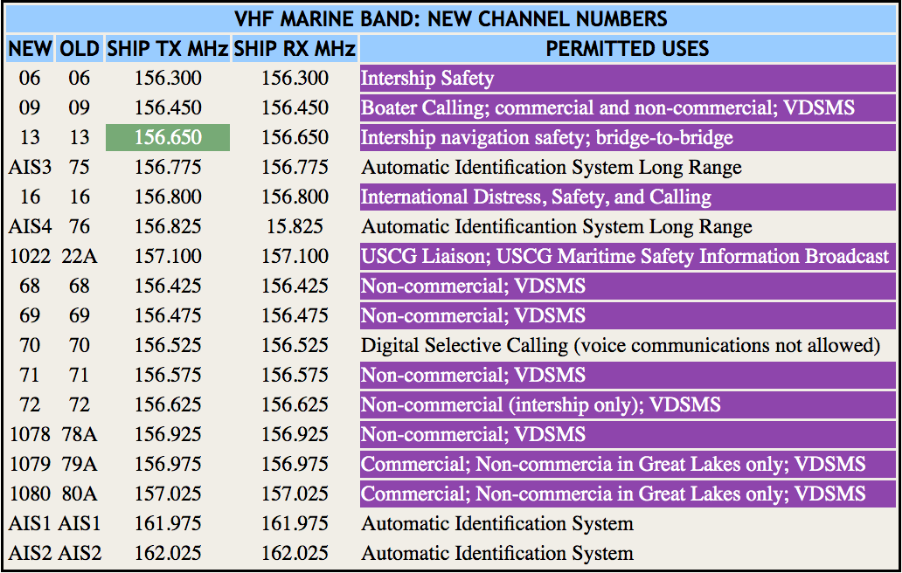

In an article in the REFERENCE section I have written about the history of the VHF Marine Band and its channelization. Below is a simplified chart of VHF Marine Band radio channels taken from that article that shows which channels are available for a recreational boat to use. This presentation eliminates the many other channels that are not available for recreational boats and should reduce confusion about what channels can be used and for what purpose.
Fig. 1. Marine Channels available to recreational boaters. Updated to include new AIS Long Range channels. Channels marked in green are 1-Watt transmit.
Note: use 1022 only when directed by the USCG.

jimh--thanks for the new info and thanks for the review. --JimP

I revised the chart shown above in Figure 1 to include the newly authorized AIS3 and AIS4 channels used for long-range transmission and reception of AIS.
