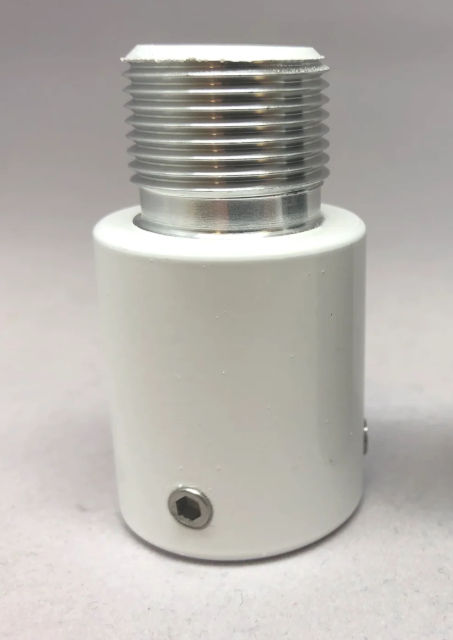

M89 is now $37. This mounts to the top of the stanchion pipe and creates the 1 x 14 thread stud for attaching an antenna or antenna mount that needs to thread onto this stud.
Fig. 1. The M89 adaptor that mounts atop the 1-inch stanchion tube, and creates a threaded stud for attaching the antenna.
