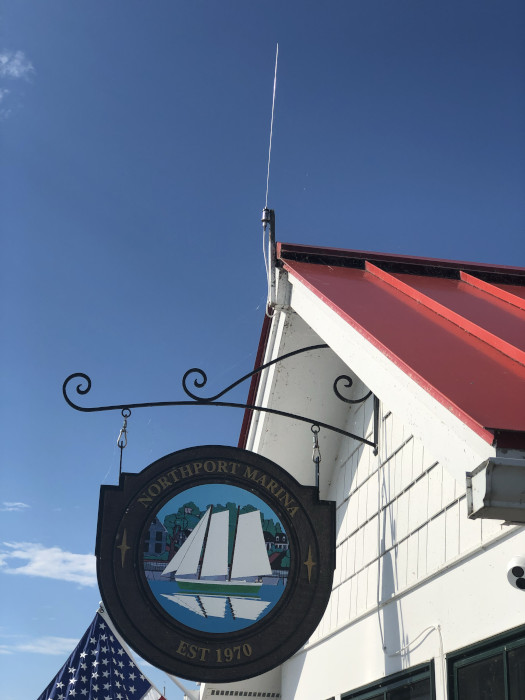

Later the same antenna and transmission line were re-tested for VSWR after the antenna had been mounted on a 18-inch wood mast above the steeply sloping metal roof of a one-story building built on a pier about six feet above the level of Lake Michigan (otherwise known as the marina dock house at Northport, Michigan). Only the VSWR at 156.8-MHz (CH 16) was tested. In this instance the directional wattmeter was located at the transmitter end of the same 22-foot transmission line. The VSWR measured was 1.24:1. Note that the 22-foot transmission line was just long enough to reach from the antenna on the roof, travel down the side of the building with two drip loops included to shed rain water, penetrate the wall of the building, form into a four-turn coil of 3.5-inch diameter (to form an RF choke to suppress any antenna currents flowing on the outer skin of the outer conductor of the coaxial transmission line) and connect to a Standard Horizon VHF Marine Band radio about 18-inches from the inner wall of the building at the dockmaster's station. The transmitter was set to the 25-Watt output position. Actual measured incident power was approximately 27-Watts, giving plenty of power for good measurement of incident and reflected power.

In this case, the antenna was installed at the dockmaster building of my local municipal marina. The change to the GAM SS-2 from the existing antenna produced a remarkable improvement in coverage for the radio installation. The previous antenna system was not working very well, with a suspected actual VSWR at the antenna of about 8:1. The range of communication was typically limited to a mile or two. Now the same transceiver can produce clear copy from ship transmissions from ten miles away or farther, and the transmitted signal is remarkably stronger.
Fig. 1. The GAM SS-2 antenna installed atop the dockmaster building.

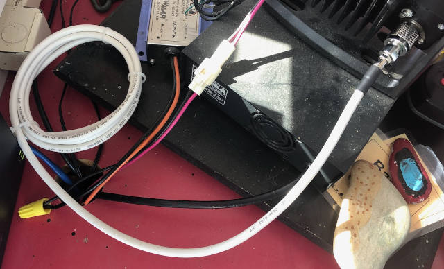

Fig. 2. The feed line passes through the exterior wall of the building (hidden to the left), and it then is immediately formed into a four-turn coil to create a choke balun, which will suppress any antenna currents on the outer surface of the shield conductor of the coaxial cable. Also note the FME connector and UHF adaptor at the transmitter (right). Using the FME connector permitted pre-assembly of the connector, which during installation was passed through a 3/8-inch existing hole (used by the previous antenna feed line).

After the installation, the transmission line reached the transmitter with about 18-inches to spare, and the extra length was then coiled into a four-turn "choke" balun to suppress any antenna currents that might exist on the outer surface of the coaxial shield conductor.
