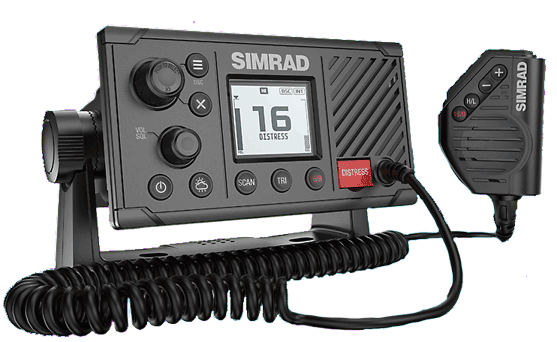

The front panel controls include a large rotary knob control that is used to select the channel tuning of the radio. I much prefer radios that can be tuned by a rotary knob to radios that use a pair of buttons to tune up and down.
The large rotary knob also functions as a selector to choose alphanumeric characters for data entry. The knob is also a pushbutton, and pushing it performs the SELECT function for the menu choice.
The smaller rotary knob is a dual-function control that can be selected to control the audio volume or the squelch threshold. This knob is also a push button, and to toggle between volume and squelch function you push the button. The LCD display shows which function is currently active.
The pushbutton marked with an X is an escape button to jump up a level in the menu structure, to delete the last data entry in a field, and to exit a screen without saving.
The pushbutton with the 0/1 marking is the power control and backlight control. Short presses of the button control the display backlight. Long pushes of the button control the power to the radio.
Another button marked with a rain cloud icon jumps the receiver to the most recently tuned weather broadcast channel.
The button marked SCAN controls scanning functions, with short and long presses giving different options. The TRI button also affects receiver scanning. These scanning features are complex, and users will probably have to carefully study the owner's guide to become masters of all the options.
The button marked 16/9 toggles between Channels 16 and 9 or a user-designated priority channel.
The red EMERG button is actually a cover that must be lifted to reveal a hidden button. The hidden button is the DSC DISTRESS ALERT call initiation button. A short press leads to a menu where the NATURE OF DISTRESS can be selected. A long press sends a DISTRESS ALERT with NATURE OF DISTRESS set to unspecified.
Consult the user manual for more explanations of the control functions.
The LCD display show about 15 different fields of icons that convey particular status information to the operator. The installation instructions properly note that the operator's viewing angle to the LCD display should be limited to not more than 20-degrees off axis in either horizontal or vertical.
The handheld microphone has unusual shape; it looks like it was designed for use in a Star Wars movie. The microphone has five buttons:
  • Push to talk
  • H/L power toggle
  • + to change channel upward
  • - to change channel downward
  • 16/9 to jump to 16 or 9 or priority channel
The microphone is attached to the main chassis, is not removable, and exits forward from the front panel.
