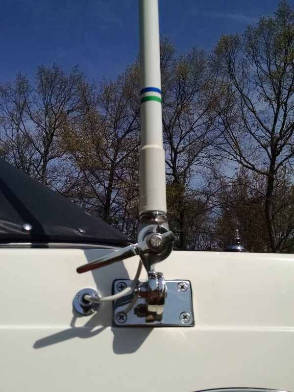

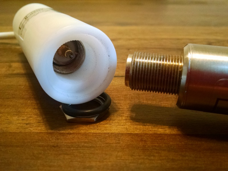

I received most of what I need today. The ADAP-II is different than what you show. The biggest concern with it is that the antenna will only thread into it about two turns because the receiving threads are way down in. The ADAP-II will need to be shortened so it can fully thread in. [There is actually no problem; see further explanation below--jimh]
Re: VHF Marine Band Antenna for Small Boats
Postby jimh » Thu May 19, 2016 7:22 pm
Contact GAM ANTENNAS to get advice. The ADAP-II looks like it is longer than the original one I got years ago. Give them a call to see what they have to say. The body of the antenna base matching coil must bottom out against the top of mount before the threads of the antenna connector bottom out in the internal connector of the ADAP-II. I wouldn't make any modification to the antenna-mounting end of the ADAP-II without advice from the manufacturer.

I looked at the fitting of the GAM SS-2 antenna into the GAM ADAP-2 mount again. The internal diameter of the ADAP-II is 1.000 inches and the outside diameter of the SS-2 is 1.003 inches. I was just not twisting the antenna hard enough when trying to thread it fully into the mount. After going back and forth a few times, the SS-2 is seated down in the ADAP. This is all probably intentional to give a good fit, and I was just trying to be too careful.

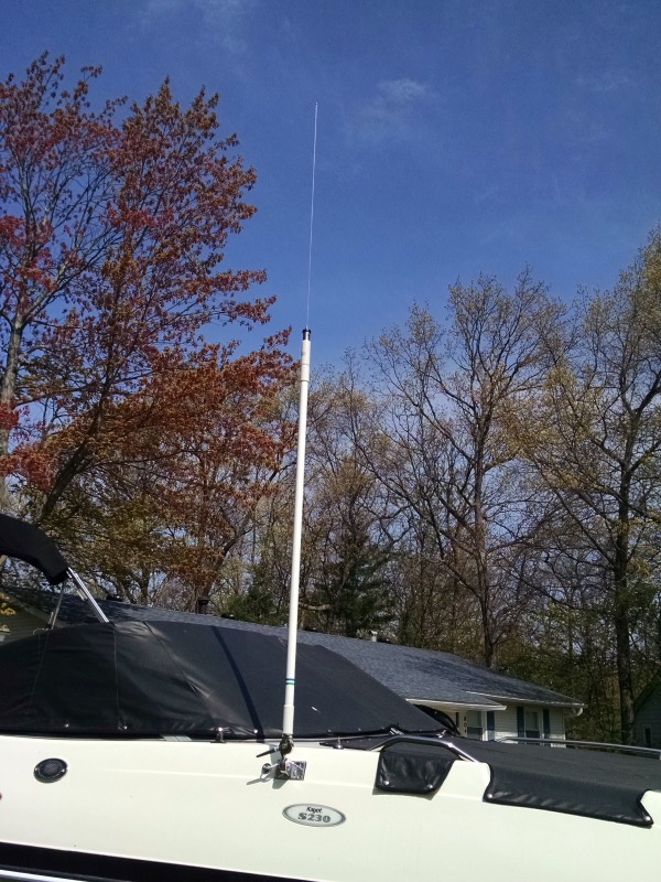

Ok, all done. I finished last night about 11:00 p.m., and, not surprisingly, nothing came across the radio. I went to bed wondering if I did something wrong despite knowing that there would be little radio traffic at that time, especially this time of year. This morning I turned the radio on and started cleaning the boat and heard the Elk Rapids harbor master hail a boat. I was in my front yard about 15 miles away, so that's one good indication.
Postby jimh » Sat May 21, 2016 7:47 pm
You installation looks good. Thanks for sharing the nice images of your work.

I can pickup NOAA stations quite a ways away. I could also receive the Sault Ste. Marie Coast Guard. Boat to boat communication is solid. Overall I couldn't be happier with it. Thanks again!
