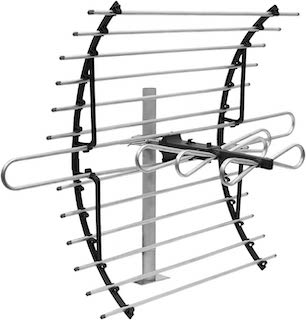

I am wondering if my attic-mounted TV antenna (pictured below) with RG-6 coaxial cable might benefit from a choke balun made by creating a coil in the transmission line near the antenna feed point--and I have slack in the cable.
Fig. 1. An attic-mounted TV antenna.

Hi Tom--most television antennas uses a conventional 300-Ohm to 75-Ohm Balanced-to-Unbalanced balun, and the 75-Ohm transmission line is just led away from the antenna in a manner to keep it near to the antenna centerline or boom.
With UHF television antennas, you can use ferrite beads slipped over the coaxial cable as a choke balun. You can buy split ferrite beads so you do not have to remove the F-connector to slip them over the coaxial cable. See
https://www.digikey.com/en/products/det ... 81/8594058
That bead has an ID of 0.354. An RG-6 cable should have an OD of about 7mm or 0.275-inch.
This smaller bead will be a tight fit; its ID is 6.60mm:
https://www.digikey.com/en/products/det ... 81/8594000
Of you could fashion a coil from the transmission line. The one on my VHF Marine Band antenna was a diameter of about three inches and has two turns.
It can't hurt turn to try a choke balun. Generally suppression of antenna currents on the transmission line tends to improve the pattern of the antenna by keeping everything symmetrical. I have used ferrite bead slip-over hinged beads on some TV antennas I have at my condo which are indoors and are pointing out a window.
