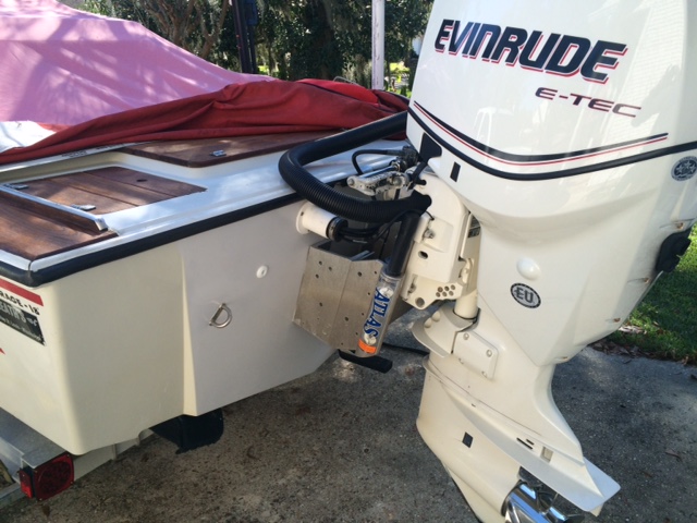

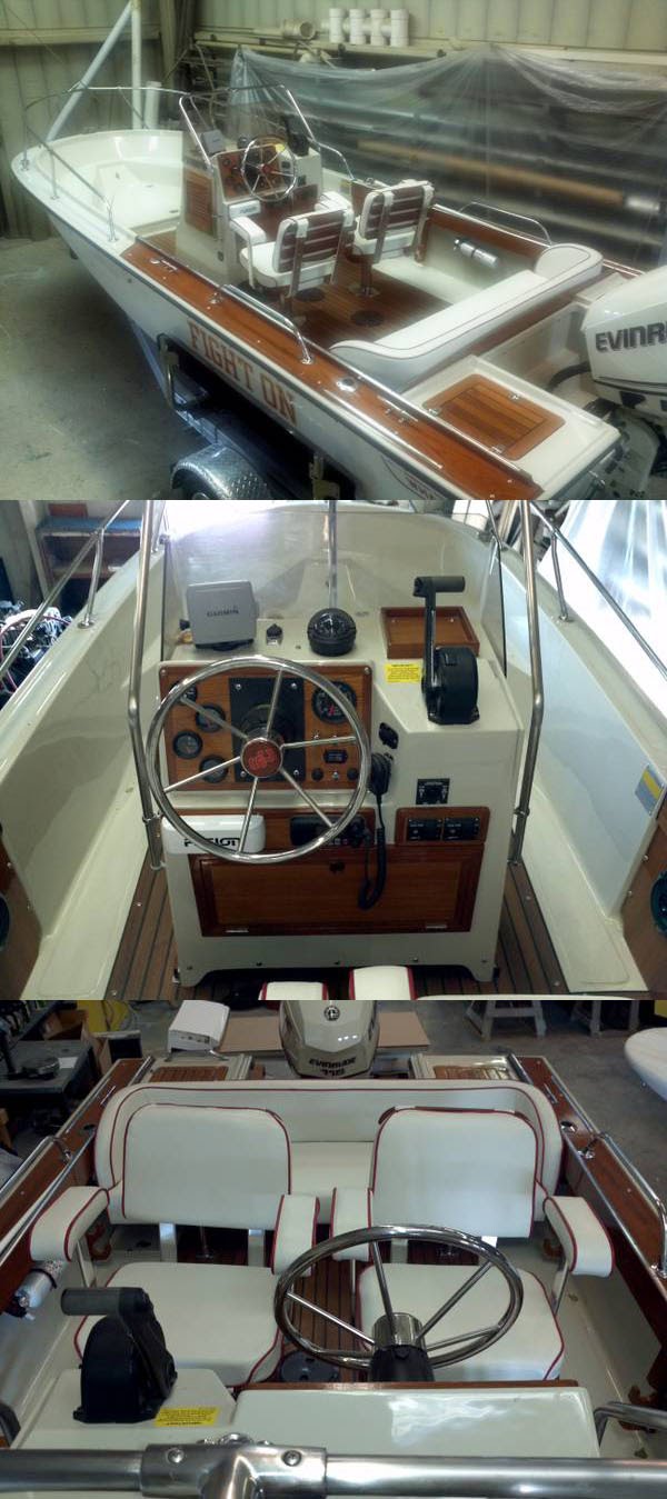

Here are a few photos of an 18 Outrage that was for sale here in Detroit a few years ago. It started as a seadrive and then had the transom center modified to have a standard outboard mounted while still keeping the stern quarter boxes. It was for sale for $18,000 which to me was a steal...
Re: Outrage 18 Closed Transom
Postby jimh » Tue Dec 01, 2015 1:03 pm
That OUTRAGE 18 with the E-TEC for $18,000--wow that was a deal. And a very interesting, one-of-a-kind modification.

Wow that is a sharp looking Outrage 18, Jeff. Very interesting, too, the way it is has been modified to almost be a cross between the "closed transom" design of the Outrage 18 and the 19 Outrage II's single-notch transom design.

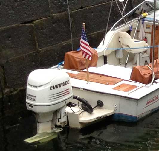

Below you'll see the aft deck and transom of a Boston Whaler REVENGE 22 that was probably originally a Sea Drive model. I believe the Sea Drive was removed and the transom repaired. An Armstrong aluminum engine set back bracket was installed. This particular bracket is quite a long set back. I don't recall the exact dimensions, but as seen below, it is a generous set back distance. An OUTRAGE 18 with a closed transom would look very similar to this, although the beam of the boat would be smaller. The Armstrong brackets are usually custom-fabricated and expensive. I don't know exactly how you go about calculating how high to mount the bracket on the hull. I think Armstrong gives you advice on that, as they have obviously got a lot of history on how to install their products.
The transom of the classic Whaler hull is not completely flat, as you can see here. The center portion is usually thicker by about an inch. With the transom closed, there must be some way for cockpit water to drain quickly. In the Whaler Drive configuration, two large, about 3-inch ID tubes are cut through the transom so the bottom of the tubes is level with the deck. These two large openings will drain the cockpit to the sea if a big wave comes into the cockpit. Normally you don't even notice these drains because their outlet openings are hidden by the wings of the Whaler Drive. The wings of the Whaler Drive are not flush to the transom, so there is about a one or two inch gap between the drain outlet that is flush with the transom and the wing of the Whaler Drive.
In the modified boat seen below, you can see a through-hull drain exhaust on the starboard side about a foot above the water line. I suspect that is the outlet for a sump pump that is intended to get water out of the aft cockpit area that is under the rear deck.
The boat shown was a good performer and seemed to ride very nicely. This boat was owned by Don J. at the time, and I don't think we ever had a flat out race between that boat and my very similar REVENGE 22 W-T Whaler Drive boat (also with a 225-HP). I would not have been surprised if Don's boat was a few MPH faster at full-throttle because the Anderson bracket would have been running mostly clear of the water.
Boston Whaler REVENGE 22 W-T with Armstrong Bracket
The anti-fouling paint water line seemed to be applied a bit high on the boat and assumed a static trim that was down by the stern. In this picture, the boat is in a lock and the crew is standing at the bow to handle a line. This results in the stern sitting a bit higher than it probably would at rest with no one aboard. The Anderson brackets do not provide as much floatation as the Whaler Drive does.

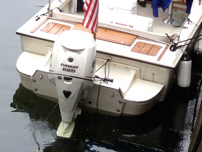

For comparison, I include a view of the same model boat, REVENGE 22 W-T, with a Whaler Drive. You can see that with only a single engine on a Whaler Drive--which was often though to be intended for twin engines--the static trim at the transom is quite high. The transom splash well drains are well above the static water line. Again, in this view, there is crew on the foredeck to handle a line, so the stern is a bit higher than normal. You can also see the wings and the gap to the transom, where the cockpit drains are concealed.
Boston Whaler REVENGE 22 W-T Whaler Drive
In both these views you see how close to the surface of the water the anti-ventilation plate of the outboard is sitting.
