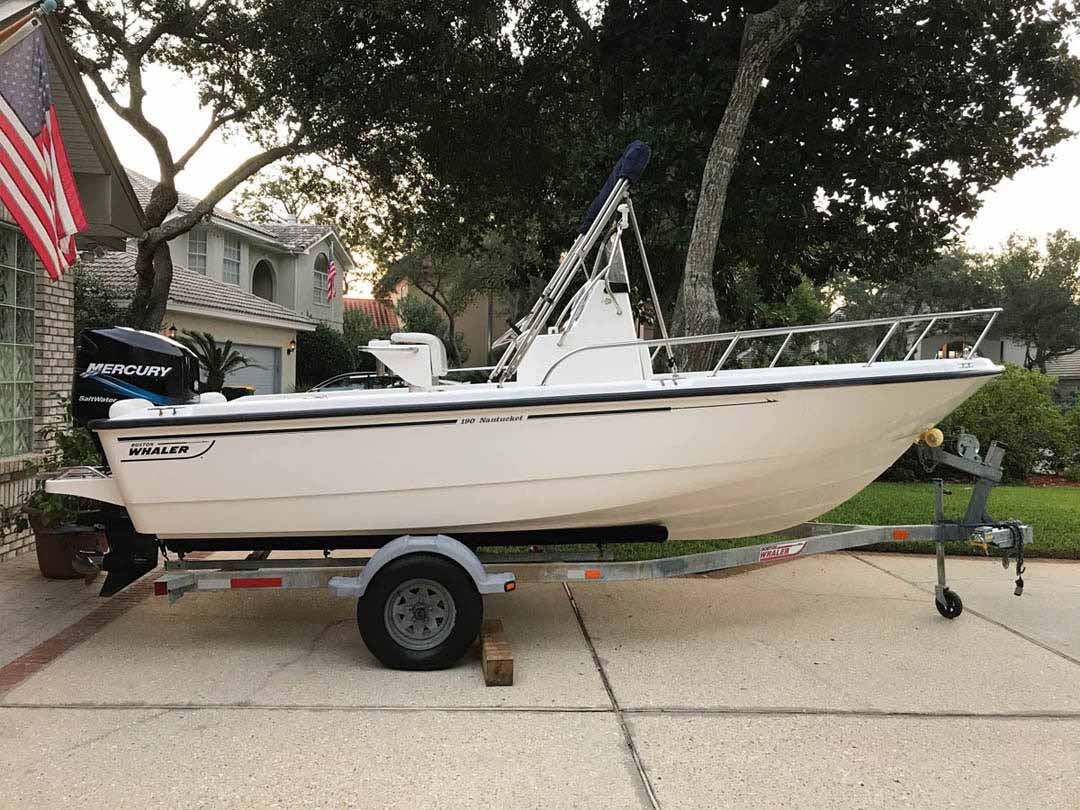

Well I just purchased my first Boston Whaler. Folks here helped a bunch. It is a 2004 Nantucket 190.
I got the boat, trailer and 150HP Optimax for $18000.00. Most everything on the boat was is excellent shape. I had been looking for 6 months or more. I sea tested this boat and the Optimax was loud. I must say the boat was extremely sturdy and solid. Power was just right. Known problems with is boat was lack of stereo, raw water wash down, trim tabs and lack of dual battery. Optimax had a problem with the belt tensioner but other than that the motor was like new. Hit 46 MPH WOT. Probably could get a couple more if I was use to the tilt. The trailer had rusty bunk board brackets which cost me $50 to fix.
As far as survey I decided against it to save some money. I ran engine with engine cowling and belt cover off. That is how I discovered the belt tensioner was not quite right. I did a compression check and took out bottom gear case plug and was happy to find no sign of water intrusion. Battery, plugs, filter, water pump were new late last year. I am hopping for a couple years of service before re-powering as folks have mentioned.

Boat Photos

Postby Dutchman » Tue Sep 05, 2017 11:32 am
Welcome to the family the boat looks great in the picture.
