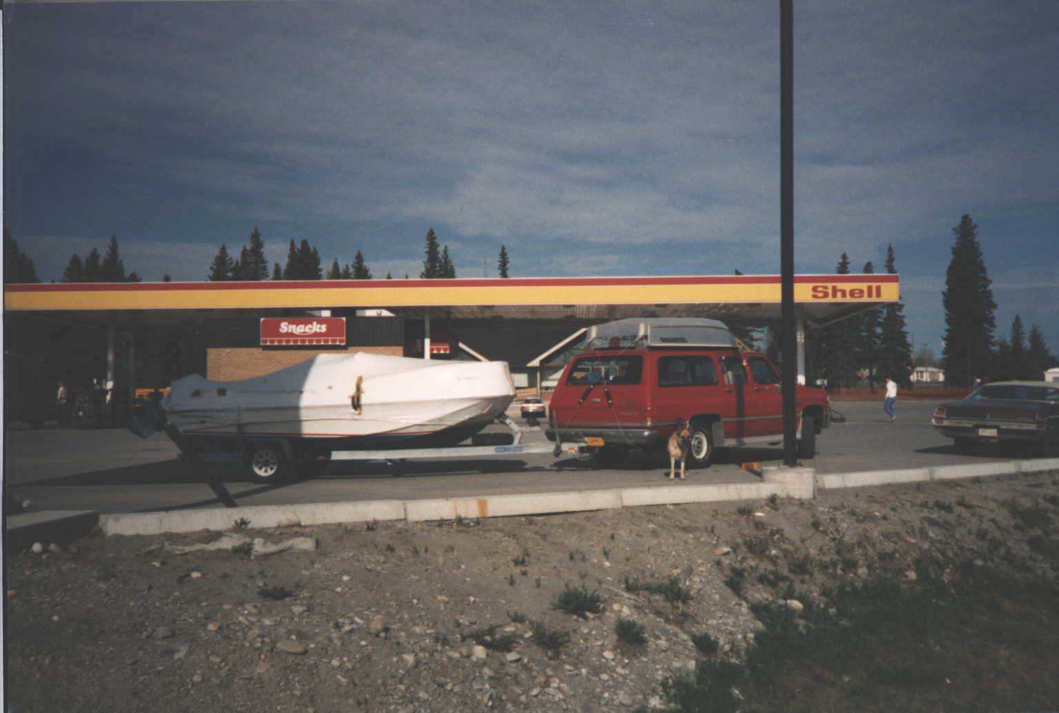

Lots of great advice. One thing not mentioned is "watch where you're going!"
Back in 1989 I towed a 1982 Montauk from Long Island, NY to Homer, Alaska (and then by 126-mile ferry ride to Kodiak) behind a Chevrolet Suburban (total length 42-feet). ~4,600 miles. No real problems and I've reported on the trip in this forum before.
Be mindful of where you are turning in an unknown area. Somewhere in Canada (Saskatoon?) it was lunch time and a Big Mac was in order so I turned in to a McDonald's. No biggie, except there was only one ENTRANCE/EXIT, the way I had come in. I talked to myself in "colorful" language but did manage to turn around with a bit of difficulty.
After that, every meal stop, fuel stop, motel stop, etc. was always carefully surveyed before turning in .
Have a fun drive. You'll get lots of people looking.

- Somewhere in Canada
- KJ1 589 CANADA1.jpg (99.44 KiB) Viewed 11817 times

JIMP's advice to watch where you are going is very good advice. Most of the problems are found when leaving the highway and getting onto local roads or turning into local businesses.
When pulling into a gasoline filling station with the boat trailer, be very watchful for the path of the trailer. Most gasoline filling stations have big steel posts protecting their fuel pumps--for a good reason--and you have to be very careful that your trailer wheel will not come in contact with those steel posts. When towing a boat, I look for a filling station with a plenty of room around each pump, and I try to use an outside lane that will permit easy turn-around. Filling stations oriented to serving trucks usually have a lot more room to maneuver at their pump lanes
Also look for overhead obstructions, particularly if you pull into a motel with an overhanging roof at the entrance to the office. This won't be much concern for towing a MONTAUK 170, but you can't be too careful.
