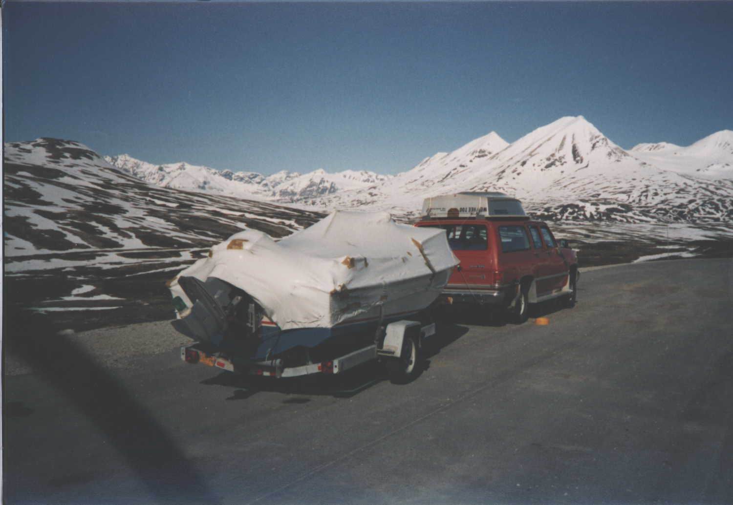

In 1992 the U.S. Coast Guard (USCG) transferred me from Kodiak, Alaska to Juneau, Alaska. My 1982 17' Montauk with 1982 90-hr Evinrude was considered part of my household goods shipment, even though I was towing the boat and I was required to get a certified weight from the nearby truck weigh-in station. The boat was fully loaded (anchor, canvas, paddles, coolers, etc.) but no fuel, trailer included. 2,060 pounds.
Attached picture is from my trip north on the Haines Highway in 1989, in 1992 we drove the same route south. This is at Chilkat Pass, 3,510' above sea level.
JimP
Haines Highway Chilkat Pass, 3,510'
