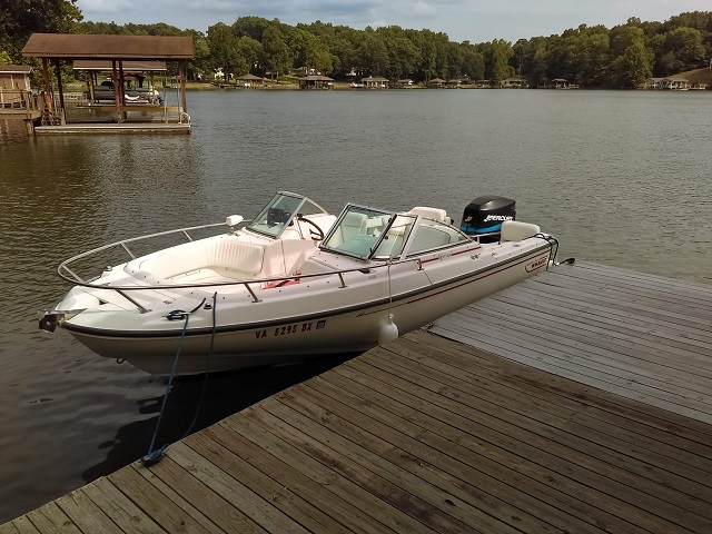

Thanks for the replies. We test drove the boat last weekend and we liked it. The 2000 200 Optimax has me somewhat worried. The VENTURA 20 looks like it has had some fiberglass and gelcoat work on the hull, but supposedly that was from too many beachings during its early years.
Tim— I was able to see what you were talking about with respect to the small hatches, scuppers, and the fish locker. I'll probably need to catch up with you if you don't mind after I have had some time getting used to the new boat. I'll probably have more than a few questions
Can a standard bunk trailer be used with these boats?
Or, should I stick with a keel roller trailer?
Thanks!
Thanks!
- Ventura 20.jpg (144.61 KiB) Viewed 9831 times

I have a 1996 20 Dauntless (exact same boat as pictured -- I *think* it was still the Dauntless back in 1999)
I believe bunk trailers are recommended over rollers and mine worked fine on my boat. I ended up selling the trailer as I rarely used it.
