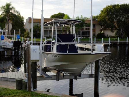

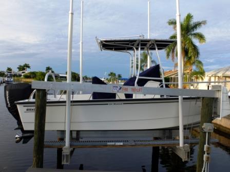

I have a 210 Montauk and use it on the Gulf Coast of Florida. Charlotte Harbor out into the Gulf up to ~25 miles offshore on a nice day - I will tow it to the keys every once in awhile. If your doing a mixed of inshore flats with some offshore reef fishing on nice days, the Montauk is a good platform with it's large elevated bow deck - on the flats this make a excellent casting platform to sight for reds - easily holding two people fishing. It's hull design also makes it very stable at rest.
Going offshore - it's a bit about planning your trips around the weather, the Montauk will certainly pound in a heavy chop while the Outrage will handle this better. In the end they are still "smaller" boats and your will get a bit beaten up in nasty weather. I have been out when a nasty front has rolled through and it's all about managing the running speed - I never felt unsafe.
I looked at the 190 Outrage and 190 Montauk but went with the 210 Montauk instead, I really like the lay-out and the extra space in the bow for fishing, plus the 210 Montauk has a nice size fish box.
Couple of pictures of her on the lift:
Member since 2005
