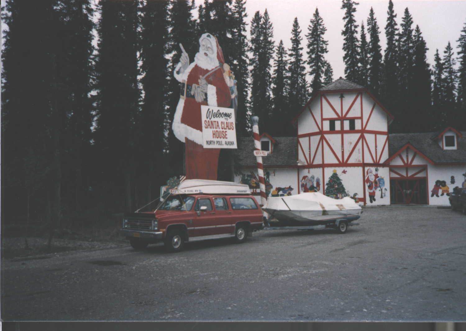

In 1992 I was towing my 1982 Montauk with 90-hp Evinrude about 1,200 miles for a Coast Guard transfer (Kodiak, Alaska to Juneau, Alaska). Since the boat was considered part of the "household goods shipment" I had to get her weighed. And the truck scale just happened to be .5 miles away. I can't remember the tongue weight, but that can be adjusted. The total weight of the boat and trailer, lightly loaded was 2,016 pounds. I was towing with a 1987 Chevy Suburban with 6.2 diesel so towing through the mountains was no problem.
In 1989 while towing the boat from Long Island, NY to Kodiak I made a wrong turn in Chicago and ended up towing past Soldier Field during morning rush hour. As others have mentioned, avoid towing through cities, and avoid mountains.
As I've also mentioned in this forum, when turning off into a McDonald's for lunch, make sure there is a clear path OUT of the parking lot. As I towed through Canada I stopped for lunch at McDonald's, pulled in, and there was only one way out... the way I had come in. Backing and filling a rig that is 42-feet long in a small parking lot is not fun.
Towing takes forethought.
JimP
JimP
- KJ1 589 NORTH POLE.jpg (117.94 KiB) Viewed 13412 times
