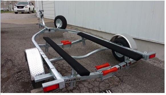

I also have a 17 OUTRAGE. I replaced my trailer in 2018 with a LoadRite model 17220090VT galvanized torsion-axle trailer, and installed keel rollers and guide posts. The 17 OUTRAGE like a glove and rides like it is on pillows. Expect to pay $2,300 to $3,000 due to Covid.
Fig. 1. LOAD-RITE trailer as purchased.
https://www.loadrite.com/trailers/load-rite-galvanized-single-axle-bunk-17/#
Also, I had this same trailer on my 1991 Outrage 17 during my seven years of ownership.

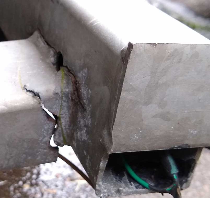

I bought a LOAD-RITE 5-STAR model galvanized trailer in c.2015 for [a different boat, a] 1987 MONTAUK 17.
The LOAD-RITE 5-STAR model galvanized trailer had four cross members, and they were welded [to the longitudinal or side rails or frame]. The joints of three crossmembers to the side rails were failing; I had them rewelded.
Fig. 2. A broken joint between the trailer longitudinal frame and the crossmember. The weldments shown are the originals. Note how the tear in the crossmember is away from the weldment.
[Moderator's note: added illustration after receiving a very large very-high-resolution image by email, which was then cropped to show only the weld area.]
In the welded design the crossmembers are only welded to the side rails on the top and sides, and the bottom of the cross member is below the side rail and is not welded. That created the problem: all the welds started cracking where the welds stopped.
I recommend buying a trailer with bolted-on crossmembers.

Now that the weld illustration has been added at Figure 2 above, we see what appears to be a situation in which the material of the crossmember was torn away at some distance from the weldment. The weldments look like they are still intact.
The failure of the material may be related to the heat from welding. The material may have become brittle in the area around the welds. Or, the stress on the crossmember created by the fixed joint to the longitudinal frame members may have exceeded the shear strength of the material. The material itself creates a long lever arm to work on the joint.

MarkCz wrote:The LOAD-RITE 5-STAR model galvanized trailer had four cross members, and they were welded [to the longitudinal or side rails or frame]. The joints of three cross members to the side rails were failing; I had them rewelded.
Did you contact Load-Rite about this?

Postby MarkCz » Mon Jan 10, 2022 12:10 pm
I initially contacted Highway Marine, [the LOAD-RITE dealer] where I bought the trailer. Highway Marine told me to contact LOAD-RITE customer service.
I sent LOAD-RITE a detailed email with pictures, including [a picture of] the sticker that had the trailer's manufacturing date and serial number; I also sent pictures of the cracked areas. For a week I heard nothing back. I called LOAD-RITE. [In the telephone conversation with LOAD-RITE ] I was told I had to start a warranty claim with Highway Marine [the dealer that sold me the LOAD-RITE trailer].
Again I contacted Highway Marine, but I did not expect much help since they were useless before.
After getting these run-around [responses] during prime fishing time, I just decided to get the [cracked] areas welded by a local welder.
Eventually LOAD-RITE contacted me. LOAD-RITE told me if I would remove the boat from the trailer, they would pick up the trailer and look at [the cracked welds].
Since I already had repaired [the cracked welds, and I] had no way to remove the boat [from the trailer] and store the boat, I did not pursue this repair with LOAD-RITE further.
I may be partly responsible for the cracking. I used to tighten down the gunwale straps very tight to the trailer side rails. But, that said, the design of the trailer is partly responsible for the failure.
The repaired areas are holding up well.
Because the galvanized coating on the steel is lost during welding, I used wax-based coating inside the rails.

Regarding your earlier advice recommending to purchase of a trailer with non-welded crossmembers, I tend to agree with that recommendation. My opinion on this topic is based on the ability to make a repair. If a bolted-on frame member fails, there is always the possibility of just obtaining an OEM replacement and bolting-on the new part. If the attaching bolt fails, only a new bolt is needed to make a repair.
But that said, for several years I owned a PACIFIC TRAILER tandem-axle galvanized steel trailer. PACIFIC TRAILERS are made in California, and they use an all-welded frame and undercarriage. These trailers are highly regarded for their durability, for use in saltwater, and for use on poor roads in remote destinations (such a Baja California). The particular PACIFIC TRAILER with welded construction that I owned was made in 1987. I put many--many-- thousands of miles on that trailer, at least 5,000-miles in one long trip to Washington state from Michigan and return. I sold the boat and trailer about 15-years ago, and I am quite certain that trailer is still under my old boat and still on the road at a nice old age now of 35-years-old.
I don't think having the boat's hold-down straps in tension would be able to exert enough force to crack a weld. I have to think the weld is going to be stronger than fiberglass or stronger than a nylon strap or stronger than the amount of tension you could apply to the hold-down strap without using some extraordinary means like a three-foot pole to exert the force onto the mechanism. I also think that excessive force in the hold down strap would act on the hull fitting it is attached to, and then the fitting might deform the fiberglass or bend the fitting.
If you consider the weight of a boat compared to the weight of a trailer, the boat hold-down straps are really not holding down the boat, they are just holding up the trailer under the boat if the the boat experiences some sudden upward acceleration that exceeds the force of gravity on the boat and trailer.
