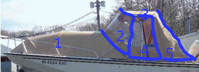

A Flying Top is one component of the Mills Weather Canvas set that includes
  1. Dodger
  2. Windshield
  3. Flying Top
  4. Side Curtains
  5. Aft Curtain
Fig. 1. Mills Weather Canvas.
