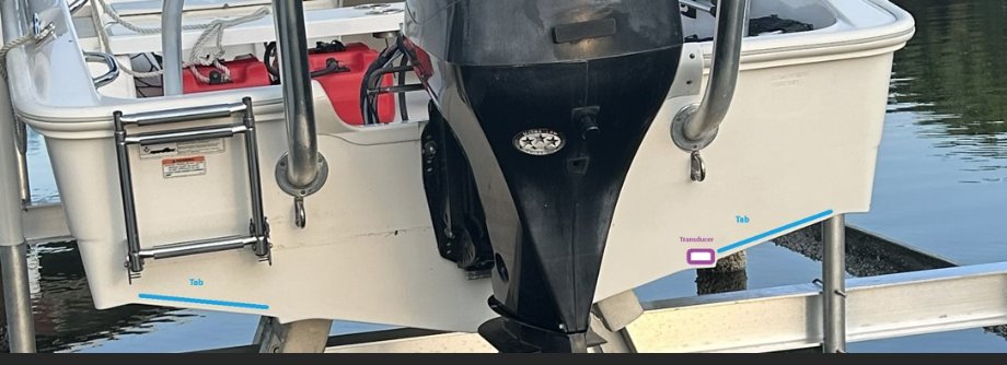

Q1: are owner-installed trim tabs unusual on smaller Boston Whaler boats?
Q2: what precautions are needed when attaching trim tabs to the transom or when routing cables from SONAR transducers through the transom of a Unibond hull?
Fig. 1. Suggested locations on transom of a 170 SUPER SPORT for mounting trim tabs (blue lines) and SONAR transducer (violet rectangle).
BW 170 Super Sport transom with markings 2.jpg (62.33 KiB) Viewed 3146 times
Q3: are the positions suggested in Figure 1 for a SONAR transducer [violet rectangle] and for trim tabs [the blue lines] appropriate?

seacatflx wrote:Q2: what precautions are needed when attaching trim tabs to the transom,,,of a Unibond hull?
For advice on locations for installation of trim tabs to a Unibond hull, see the article in the REFERENCE section at
Trim Tab Installation
https://continuouswave.com/whaler/refer ... mTabs.html
and some follow-up comments on that article are available at
Trim Tab Installation (discussion)
https://continuouswave.com/ubb/Forum3/HTML/012417.html

seacatflx wrote:Q2: what precautions are needed when...routing cables from SONAR transducers through the transom of a Unibond hull?
For advice on mounting a SONAR transducer to the transom of a Unibond hull and routing of the cables associated with them, see
SONAR Transducers
https://continuouswave.com/whaler/refer ... ducer.html

There is a reason why you mostly see tabs on bigger boats, starting at 20'. But that is here nor there for the original poster. For a 17 Super Sport I would put a DoelFin on the cavitation plate. Just me. As for the transducer location, you will find problems with it so close to the tabs. find another spot on the transom with clear water underneath. Good luck

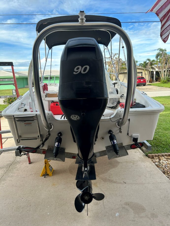

The installation of Bennett Bolt Trim Tabs has been completed. Bennet Support was very helpful. I also installed the Garmin GT-20 transducer.
Fig. 1. View of transom showing the installation of trim tabs.
Trim Tabs and transducer installed.jpg (139.17 KiB) Viewed 2306 times
I plan to test it this weekend.

[The installation of trim tabs as seen in Figure 1] looks clean.
Q4: where are the wires to the tabs routed?
Q5: are the the wires to the tabs all the way through the transom and put in the rigging tube?
Re: 2010 170 SUPER SPORT: InstallingTrim Tab, SONAR Transducer
Postby jimh » Fri Sep 11, 2026 8:34 pm
Q6: as seen in FIgure 1 above, why was the GT-20 SONAR transducer mounted so far from the centerline?
It looks like the transducer would be liable to be running in aerated water when the boat is on plane at speed.
Q7: are you experiencing any loss of the bottom echo when the boat is on plane?

NorthShoreWhaler wrote:[The installation of trim tabs as seen in Figure 1] looks clean.
The wires go through the transom at the top of the actuators. Well sealed with 5200 per Bennett's recomendation. I know about 5200 vs 4200 buut went with Bennett's recomendation to be on the safe side. This will be the 4 th set of Bennett's I have owned over the years. Never had to remove them and I consider the tabs to be permanent.

jimh wrote:Q6: as seen in FIgure 1 above, why was the GT-20 SONAR transducer mounted so far from the centerline?
GARMIN recommends a minimum spacing of the transducer from the centerline of the propeller of 15-inches. The trim tabs were at that location, so I did not have a lot of options. I will test next week when I launch the boat after the upgrades are done.
