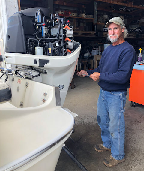

Fig. 1. Chief mechanic Bill buttoning-up the side panels on the engine at 2:19 p.m.
