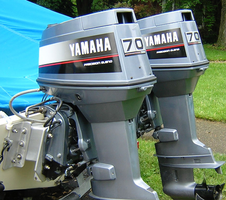

The 10-inch engine set-back brackets by Springfield were also used on my REVENGE 20 W-T with twin engines. They were a very good choice as they were relatively light, had a big set back, and could provide a lot of lift. Unfortunately, as I recall, there was a fire at the Springfield plant that made them, and the tooling was lost, resulting in them being no longer available--at least not available 15-years ago.
Fig. 2. Springfield 10-inch setback bracket on continuousWave.
The hydraulic steering used a single ram actuator that was rigged between the engines. On my boat the actuator was mounted onto the port engine, and connected to a drag link to the port engine. A tie bar connected the port engine to the starboard engine. This arrangement put the steering ram actuator in a protected location between the two engines. LHG's boat was rigged with the actuator on the starboard engine.

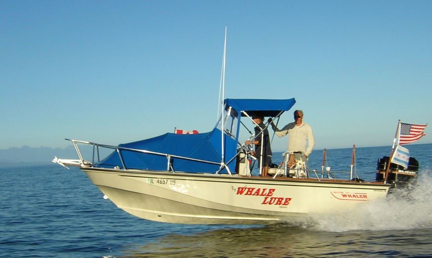

The OUTRAGE 18 with the twin 115-HP was really over-powered, and it was very fast. It essentially never was run with both engines wide open, as it was just too scary. The engines were rigged with three-bladed Mercury LASER II propellers (as best I can recall) and they produced significant lift. As seen below in Figure 1, the boat could run at speed on plane with only a few feet of the hull bottom in contact with the water.
Fig. 1. T/T WHALE LURE on plane in the cold saltwater of the Strait of Georgia. Taken by the author on August 19, 2003, on a very fast 27-mile run from Nanaimo to Secret Cove, British Columbia, Canada. Boat speed in this view about 30-MPH, as the chase boat (my REVENGE 20 W-T with twin 70-HP engines) was close to its maximum speed. Both boats had just topped off all fuel tanks in Nanimo, and were heavily loaded with gear and supplies for the long trip ahead.
