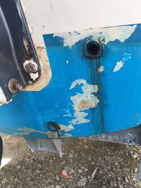

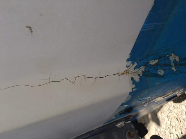

Hi. I'm looking at 15-foot Boston Whaler boats. I found a Center Console 15 I like, but the transom looks a bit scary. The first photo (which needs to be rotated 90 degrees to the right) shows a long crack nearly the full length of the transom from top to bottom. You can see at the bottom the stain from water leaking out of the transom which is wet. ( I didn't need my moisture meter to see that!)

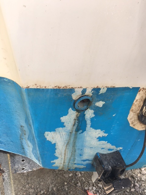

The second photo shows similar stains from water leaking out of the hull at the drain tube. All three tubes in the transom where shot and showing signs of water leaking out of the transom as the boat sat in the yard over the winter.
Is this long crack a common problem for classic Boston Whaler transoms?
Should I walk away from this boat or is it an common "before" picture at the start of a standard restoration?
Also, it appears from the second photo that the drain hole is two-thirds of the way below the water line. Is that normal for a 15-foot Boston Whaler?

The first image shows a long vertical crack at the portion of the transom on a Boston Whaler 15-foot hull where the transom thickness increases for the center reinforced area where the engine is mounted. You can compare the appearance of the boat in question with other hulls in excellent condition that can be seen at:
http://continuouswave.com/whaler/reference/graphics/15Bracket/brktphoto2LR800x600.jpeg
http://continuouswave.com/whaler/cetacea/cetaceaPage50.html
In my opinion the appearance of a crack at that location is very unusual. It is possible that the crack is located only in the gel coat layer and might be considered cosmetic, but even if that is true, I would be highly suspicious of the cause of the crack. A crack in the gel coat would only have occurred if that area had been subjected to very high stress and tried to flex. Since the gel coat is not very flexible and can be brittle, it cracked, leaving behind evidence of the high stress that caused the crack.
The strength of the transom must be investigated to determine if it has been weakened and has become flexible. Use the gear case of the outboard engine as a lever arm, and try to move the engine relative to the transom. The transom should not flex.
If there has been ingress of water into the transom's wood reinforcement and the transom is weak, repair of such a major defect would be difficult and expensive.
The second image shows stains from water that has drained out of the two drain outlets. I suspect the boat was left uncovered when out of the water, and water that accumulated in the engine splash well drained out of the upper drain. Water that accumulated in the cockpit sump drained out of the lower drain.
The location of the water line of the anti-fouling paint on the hull being above the engine splash well drain could be reflective of two situations:
--the water static water line of the hull is about where the anti-fouling paint ends, and the engine splash well drain is normally below the static water line, or
--the anti-fouling paint was applied to high, and the actual static water line of the hull is lower, putting the splash well drain outlet at or above the water line.

The boat was covered, so the dark water stain from each drain tube is actually water leaking from the inside of the transom to the outside. That is also clear on the port-side tube above.
Also, on the left side of the port-side photo, there is a pinhole with the same dark stain.

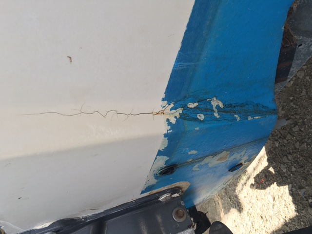

Also, I think the long vertical crack is more than superficial gelcoat cracking because the same dark stains are there indicated that water is leaking from the inside of the transom to the outside through that crack. Attached is another photo of the crack which shows this more clearly.
Is there just foam behind that crack for coring material?

That the boat was covered, and that water is leaking out from the inside the Unibond hull is just more bad news about this hull.
The Unibond hull does not use foam as "a coring material" in the sense that the foam is part of the materials before they become the hull. The foam is really an important part of the hull structure. The Unibond hull is really a double bottom hull in which all the space between the two hulls is completely filled with foam that is applied and cured under pressure and has a higher than usual density. Become more familiar with Unibond hull construction. Read
