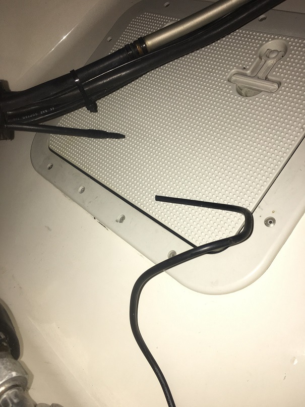

The most common problem with these gauges are:
--the hose fell off the back of the gauge; the remedy is to reconnect the hose to the gauge;
--there is some blockage in the hose; the remedy is to disconnect the hose at both ends, drain any water in the hose, and use air to blow out any blockage;
--the hose fell off the outlet fitting on at the engine; the remedy is to reconnect the hose to the outlet fitting.
If the gauge is properly connected, there is no blockage, and no water pressure reading is seen, this may be evidence of a serious problem in the engine cooling system.
In most outboard engines the raw water cooling system has another outlet that directs some of the cooling water overboard, usually through a small orifice or nozzle, creating a spray stream. This is called a confidence stream or an overboard indicator, or by various vulgar terms related to urinating that I won't mention. If there is no flow on the overboard indicator, this is also a problem. Much like the pressure gauge, the problems are often related to a blockage in the hose connection between the engine and the nozzle, an obstruction in the nozzle from some small object coming out of the cooling system, or an obstruction in the nozzle outlet from some external object like a mud-wasp nest.

That gauge shows engine water pressure. There is a small 5/16" black polyurethane hose that comes off a fitting on the lower right side of the engine and goes with the control cables through the under-deck tunnel and terminates at the back of the gauge. I just replaced mine this year because it had deteriorated from sun, and even more from what I guess was mouse teeth. Stupid rodents. Others have reported that the hose is easily plugged up if you are running in salt water; I haven't experienced that but I could believe it. You might disconnect it on both ends and flush it out with a hose. The disconnect fittings are funny, very similar to SharkBite connectors for PEX plumbing. You push in on the ring on the back of the fitting and gently extract the hose. If you break the hose off you will have a heck of a time getting the broken piece of hose out of the fitting. Trust me on this.

I can't wait until this weekend to take a look at the water pressure gauge so I took a picture of the boat. I found the hoses. One is sticking out from the engine end where you described but it does not have any hole! And it has all these grooves. I am not familiar with "Sharkbite" connectors. The other end is the hose and when I blew some air in it, i could hear sounds of water gargling. I've been wondering these 2 hoses since I got the boat and they're just there.

That hose coming out of the engine to the left of your photo is not the water pressure hose, that's the speedometer pitot hose. There's a pickup on the front of the lower unit that feeds this hose, the faster the boat goes the higher the pressure. But the 160 Dauntless does not have a speedometer in its instrument panel, so this hose is just capped off at the engine and goes nowhere.
The water pressure hose comes off the engine block low on the starboard side of the engine, and is the smallest of the hoses in the bundle coming out of the engine cowling. It is black polyurethane hose 3/16" interior, 5/16" exterior diameter.
The fitting I'm talking about is a "Legris" fitting, which you can see here: https://www.zoro.com/legris-male-connector-tube-516-pipe-14-pk10-3175-08-13/i/G2391401/?gclid=Cj0KEQjwnIm7BRDSs42KxLS8-6YBEiQAfDWP6Mh5x5fT7JuKioBWSYdk_KyZZL3q28Z36ST-Fn8vQAgaAnu78P8HAQ&gclsrc=aw.ds. You simply push the hose into the back of the fitting (that is, into the right side in that photo) and little teeth inside the fitting catch the hose. To remove the hose, you must push in the back of the fitting (the little black ring on the right in this photo) and gently remove the hose. There is one of these fittings on the engine and another on the back of the water pressure gauge. You will need about 20 feet of tubing for this; I bought 15 feet (thinking "how much could I possibly need, it's only a 16 foot boat!") and it made it only to the floor inside the center console.
I'll see if I can get a photo of the fitting on the engine.
-Bob
-Bob
