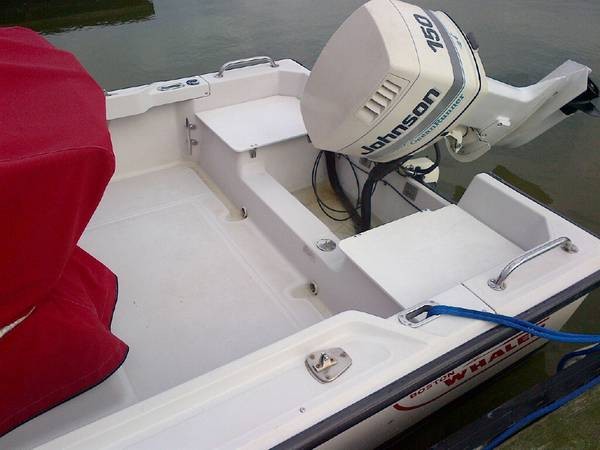

Is the this the same stern as your boat? Is the water level similar at rest?

Photo of 1995 Outrage 19 stern

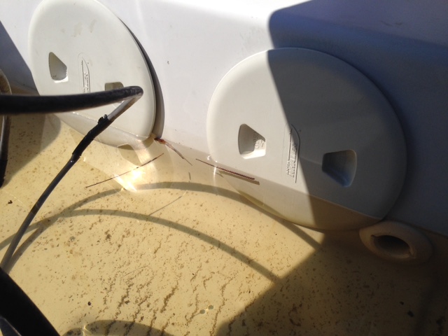

Thanks you for your input. I have not plugged the transom drains, nor have I plugged the drains into the motor well from the deck. See attached photo of the two access holes. My boat looks exactly like the one in the photo. Thanks again.

When the boat is at rest and at static trim, if the water level in the engine splash well rises to a point where water can flow lower in the boat by those large diameter access ports in the wall of the splash well, then water will flow along that path and begin to collect at some lower point.
The only remedy is to improve the static trim so the boat is not settling down by the stern so much that the engine splash well floods that deeply, or to make a very water-tight seal for those large access holes so that no matter how high water rises in the engine splash well it cannot escape and begin to down-flood the boat.
Where does that smaller drain (seen in the lower right of the above image) lead to? Is that an overboard drain?
