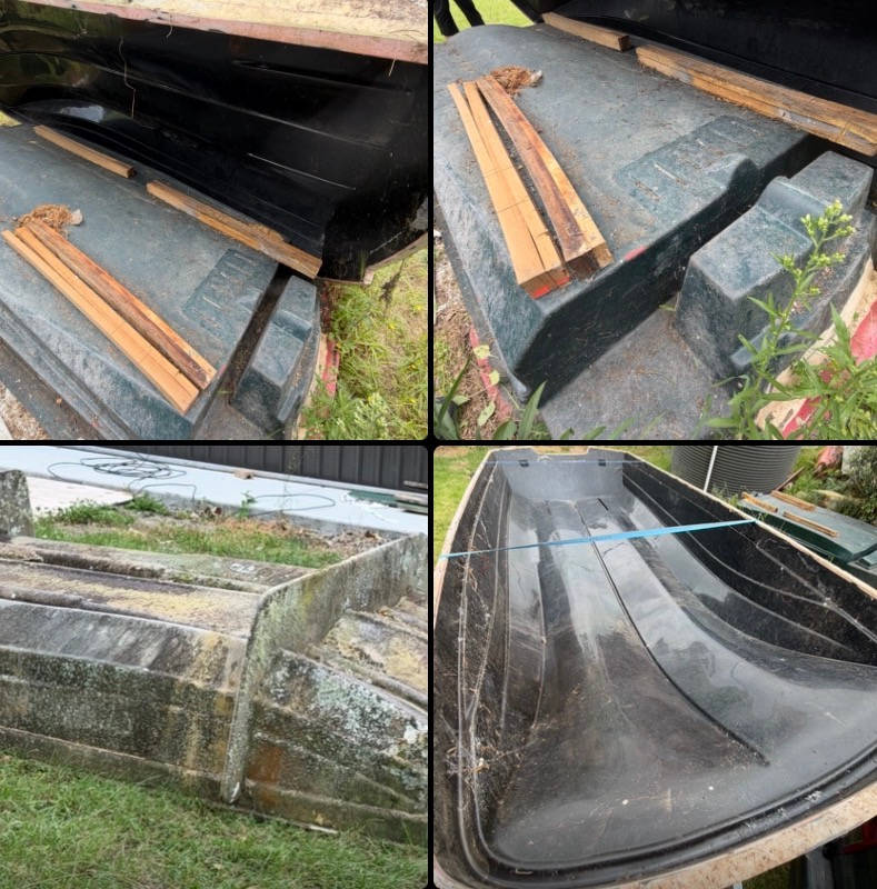

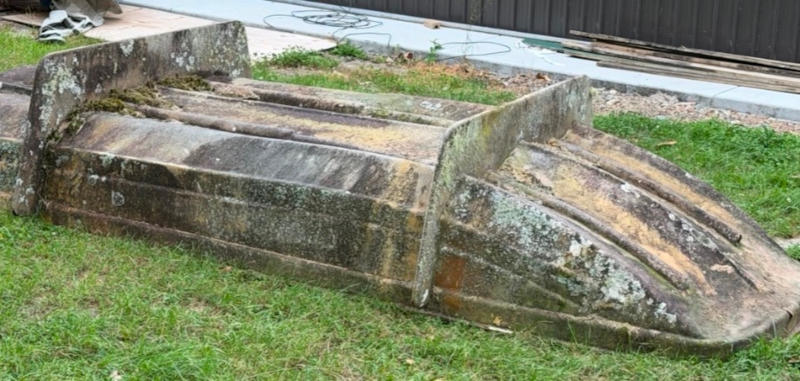

Give me advice on the exact layup [specifications] and [laminate] construction to use with the two-piece mold seen in Figures 1 and 2 below from an unknown boat mold.
Fig. 1. Four views of a hull mold
Fig. 2. A hull mold.
BACKSTORY
I am a boat builder in New Zealand. I have an old two-piece mold for a hull of about 5-meters length. I am not sure on model. I’m considering giving making a hull a go on this mold. It’s in reasonable condition considering its age and it’s been stored outside.
I could guess using gelcoat, polyester resin, and a few layers each side of some foam mat but I’d like to know what’s best.

jimh wrote:Q1: do you think this hull mold was originally used by Boston Whaler to create a Unibond hull?
I think someone made a mold off a [Boston Whaler 13-foot hull] here in New Zealand. This mold was made very professionally. It has lasted while stored outside. I’ve since found out it’s looking exactly like a 1968 13-foot Boston Whaler boat.

Postby jimh » Sat Mar 14, 2026 9:02 am
NZwhaler wrote:I found of a restored boat with the same hull liner.
There thousands of old 13-footers, but I do not see any reason the boat in your linked article is particularly able to authenticate the mold you found.
For some individual to use an existing older 13-foot Boston Whaler hull as the plug from which to make a female mold for laminating a similar hull would not be unusual, but you cannot create a Unibond hull from that mold. To make a Unibond hull you need two molds, one for the outer hull and a second for the inner hull or hull liner. Both molds must be reinforced so they do not flex or bend under the considerable pressure created by containing the expanding foam that will completely fill all the space between them.
Further, the liner mold must have a large sprue hole and also distribution vents to allow air to escape. The molds must be oriented at a particularly optimum angle to best encourage the foam to expand into every section of the available space.
And, very important, you must incorporate shear braces to structurally link the hull and liner parts together throughout the two molds.
Finally, you need to join the two sections and introduce the foam while the laminating resin in both halves is still curing.
This is a rather massive undertaking. If you want a 13-foot older Boston Whaler, just buy one and refurbish it. That is a much simpler project.
