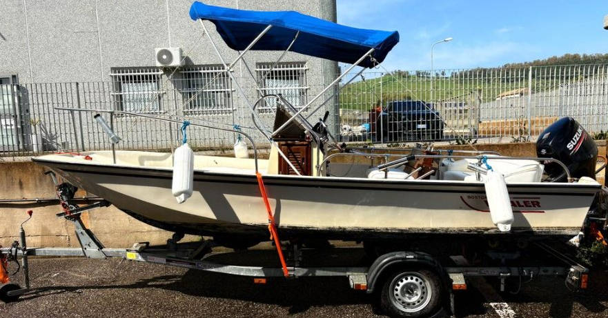

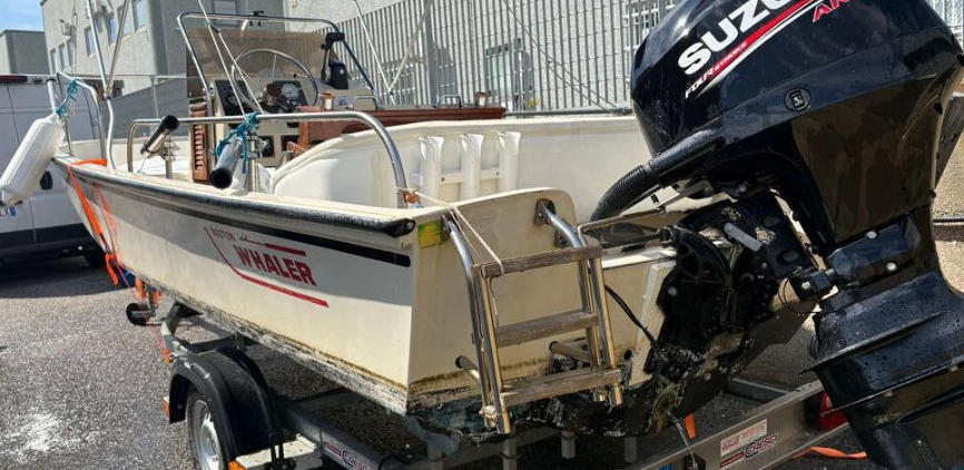

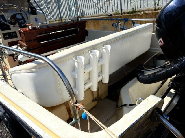

I'm negotiating the purchase of a 1983 MONTAUK [17] in Sicily. The boat has been in a covered shed for about two years now. Previously it was used in sea water. From the pictures in Figures 1, 2, and 3, I have a serious concern the boat is waterlogged, given the waterline tilted aft and the marks of dirt above the splash well drains. The bottom drain seems to be replaced with some brass fitting.
On the other hand the owner has fit a shower tank under the aft seating with the pump and the related equipment.

The water line marks seem to indicate the static trim on the boat will cause the engine splash well drains to be slightly submerged. This is likely a result of the heavy four-stroke-power-cycle engine and the wrap-around aft seat. A common change when older boats are re-powered with modern engines that are significantly heavier than the original two-stroke-power-cycle engines for which the hull was designed is to move the battery out of the stern and forward to be in the center console. Also any fuel tanks should be moved out of the stern and forward. If there is a large capacity tank under the wrap-around stern fuel tank, consider moving that forward. Typically a fuel tank would be located under the reversible pilot seat. There are Moeller-brand on-deck fuel tanks that are specifically designed for to fit under the reversible pilot seat.
The anti-fouling paint on the hull indicates a prior water line that would have left the engine splash well drains above the water.

The horsepower of the engine is not mentioned and is not clearly seen in the illustrations, so the value of the engine is not determined. The engine value will be an important factor in the selling price. The engine appears to be a modern four-stroke-power-cycle engine, so that is a big plus in value. If the engine is 75 or 90-HP, that is also a plus factor. You do not mention the year of production of the engine, so readers again have little information to assess its value.Q5: is the boat/engine/trailer shown worth a price of US-$17,000?
Because the boat in question is already in your country and convenient to you, to assess the market value of the boat in Venice, Italy, is very difficult for readers in the USA.

ASIDE: as seen in Figure 2, the method of using an orange tie-down strap wrapped around a bow railing stanchion base is not a good method for securing the hull to the trailer.

ASIDE: to me, the Bimini Top looks like the orientation is backwards. The shade created will not be over the driver at the helm seat, which is the actual purpose of the Bimini top.
Also, the aft strap that exerts tension onto the tubular frame of the top is typically oriented almost straight down from the frame to a pad eye on the gunwale. As seen above, there is a strap or rope of some kind that is angled far aft for attachment to the hull. That is a very poor orientation; it creates a big obstacle for getting on the boat from a dock or pier, and also would interfere with fishing lines if you were angling for fish with rod and reel.

Checked the boat from the back, it had the drains submerged :(
Also the owner said he usually kept it in the water without the plug. After the rain it usually had 2cm of water inside up to the consolle……
The biggest concern anyway was the engine fastenings inside the splash well. They had broken the gelcoat ad ended up inside the glassfiber.
There were marks of impact of the engine with a wall, probably insorge the guy’s garage. The engine was working ok anyways.
