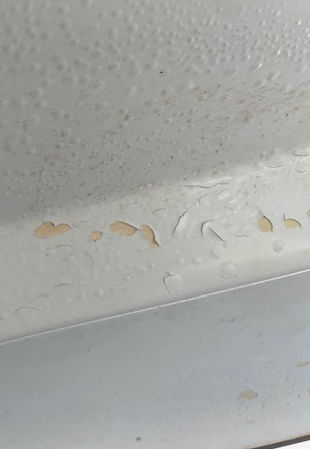

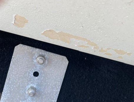

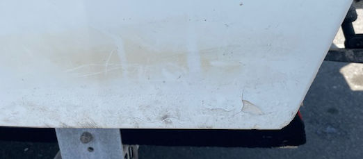

Q1: what condition is the hull as seen in Figures 1, 2, and 3?
Fig. 1. Hull blisters
Fig. 2. Hull wi th chipping and blisters.
Fig. 3. Hull with chipping gel coat.
[The boat seen above] is a freshwater boat that I may purchase. There is some chipping and flaking of the gel coat and tiny bubbles on the bottom of the boat. Other than the chipping and bubbling, this 1981 SPORT 17 looks like a new 45-year-old boat.

Photos are not great, but safe to say a fresh water boat with no barrier coat and pimples on tis bottom has osmotic blisters. Water passes thru the gel coat and reacts with chemicals in the fiberglass and cause the bumps to appear. If you pop one, it will most likely contain water.
The only good repair is to resurface the bottom with epoxy, and paint, as the condition will only get worse with water exposure if not treated.
I would look for another boa.
Also, the hull looks to be peeling paint.

Little Mule wrote:...I am not sure on the original paint and gel coat.
From the illustrations you have provided, determining if the chipped areas are paint or gelcoat is just speculative. The appearance is more like loose paint.
