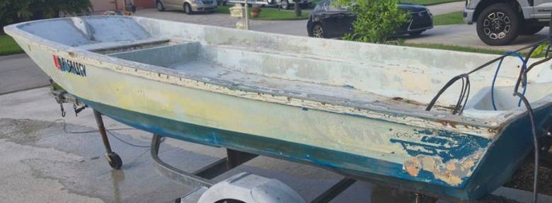

Fig. 1 View of a 13-foot hull with no interior components visible. We do see a sink-style engine splash well, a long-thin rectangular bow locker, and the absence of any step pads in the bow quarter decks. There is no rub rail left to see, and the bow is not seen from head-on to assess if there is a "smirk". All of these elements are useful in determining the production epoch of a 13-footer.

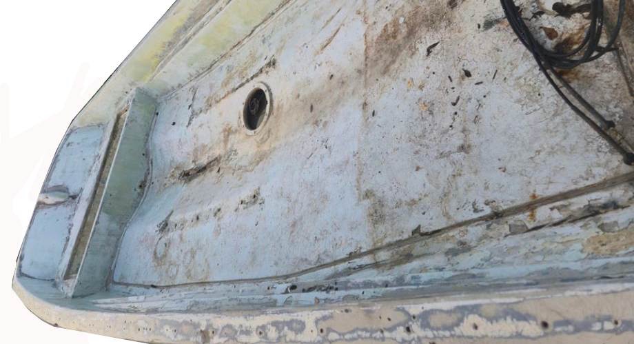

Fig. View of the stripped-out interior with debris and dirt. The most interesting element seen here is the circular deck access plate.

The only source of model identification is from the hull appearance, particularly with its ORIGINAL INTERIOR COMPONENTS in place, with the assumption that however it appears now in 2026 after having been made in c.1977, that nothing significant in the interior of the boat has changed in those 49-years since it left the factory.
Since there are no original interior components seen in any of the illustrations, there is no basis for readers to infer any particular model configuration for this hull.

However, there are two elements that have been reported for 1977 production year boats, that do not appear in this 1976-production but 1977 model year boat. The first variation is the shape of the bow locker. The shape of the bow locker changed in c.1977 production to a more square-ish rectangle from a long, thin rectangle, and in Figure 3 we see that the bow locker is the old style long and thin rectangle shape.
The second variation from expected is there are not two step pads molded into the bow at the port and starboard bow quarters. There is just the thin gunwale section on this hull as seen in Figure 1.
On this basis, perhaps the "1977 production" for those changes began around July, which was typically when the model year changed to the coming year, in this case for model year 1978 boats.

You must be seeing something not shown to readers in your three illustrations, as nothing in Figures 1,2, or 3 suggest a particular model type.

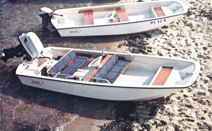

The REFERENCE article on the 13-foot hull mentions the SOURPUSS was in production from 1971 to 1975. That model may have been omitted from the catalog listings after 1975 but perhaps a dealer could have possibly ordered a SOURPUSS version as a special order sometime after 1975. But again, the basis that this boat was a SOURPUSS seems very speculative at this point.
In the 1975 catalog the SPORT 13 is described as available in two variations: center steering or side-steering. To create the SOURPUSS model, you need to add to the center-steering SPORT 13 model a wrap-around stainless steel railing and a backrest on the helm seat, and add blue seat and backrest cushions to both the helmsman's seat and the seat forward of the steering console.
Fig. 4. Two models of the 13-foot hull as shown in the 1975 catalogue: a SPORT 13 with side steering, and a SOURPUSS 13 with center steering, wrap-around railing, seat back, and blue cushions. For c.1975, we see that the bow locker has not yet changed, nor have the step pads been added to the gunwales at the bow quarters.
SPORT 13 with side steering and SOURPUSS 13.jpg (69.76 KiB) Viewed 1432 times
From a reader's perspective, we see none of those elements of the SOURPUSS in the photographs of the boat under discussion.
