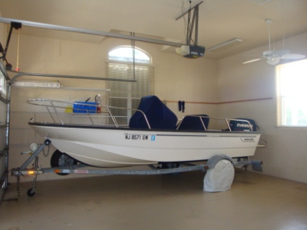

Now if you get creative you might beable to get a 18' in the garage. My garage was right about the same size as yours and I was able to squeeze a 19' triumph in it. I had to put tape on the floor so I knew exactly how and where it needed to be because if I was off on angle or position even just a little it wouldn't fit. I even had a angle the outboard had to be. Had to be trimmed down and turned to the side. Put a swing front on the trailer..

My 170 Montauk on it's factory trailer with swing tongue is 20' 4" - If you shorten the bow stop or have custom made bow stop and move the bunks forward - I think you might be able to get the length where you need it. You might need to move the axle forward also to get the correct tongue weight.

StormWarning, I don't see any way of fitting even a 17 in there, 18s are out of the question. My 15 looks like RidgeRunners Montauk, just enough space. Which by the way looks admirable RR! I like the Montauk but need a heavier boat with higher gunwales for the offshore use.
