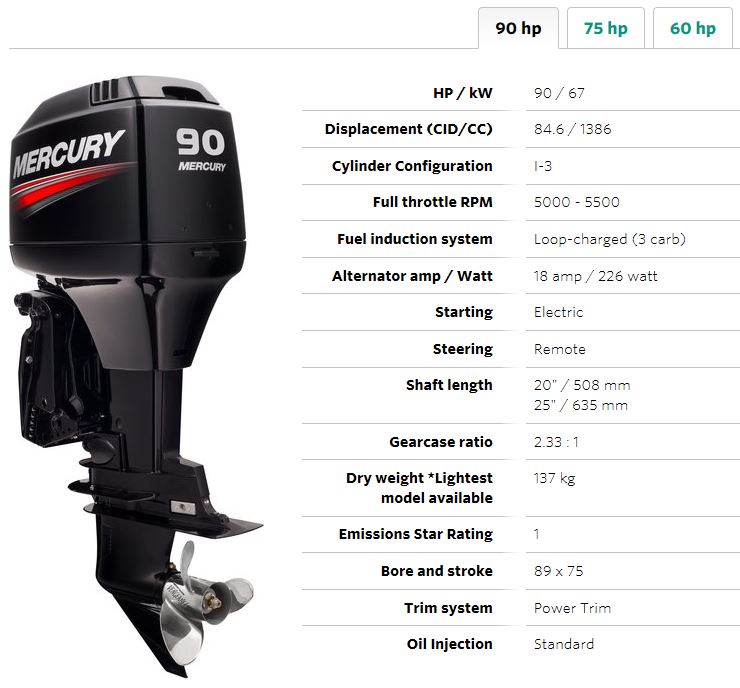

Posted: Sun Jul 30, 2017 11:05 pm
by Ridge Runner
That Mercury 90-HP ELPTO two cycle is a work horse.
General Specifications on Mercury 2001 90hp 2 stroke:
Full throttle rpm range: 5000-5500
Number of cylinders: 3
Piston Displacement: 84.57 cu. in. (1385.8cc)
Cylinder Bore: 3.500 in. (88.9mm)
Stroke: same 2.930 in. (74mm)
Gear Ratio: 2.3:1
Weight: 303lbs
At 303lbs your current Mercury 90 is a strong light weight engine with very good torque (the Mercury 90 two-cycle is reported to be in the 100hp range). That engine is still sold outside the US: https://www.mercurymarine.com/en-gb/au/ ... /40-90-hp/ (click on the continue to Australia / New Zealand - Australia site).
Merc 90.JPG (76.03 KiB) Viewed 28187 times
Personally, I would not re-power with anything but the Evinrude E-TEC 115HO (~127hp) - which is a V4 and weights in at 390lbs. You would need to check if 90 more pounds on the transom will put the scuppers under-water.
You don't mention the brand and model of the left-over 115hp engine that your dealer has. Check the specifications of that motor as weight will be a problem.
Based on the performance you stated "25-MPH and engine maximum was 5,000-RPM" there is something very wrong. When that boat was new the performance reports with the Mercury two-cycle 90HP, reported a top speed of ~39 MPH with a tendency to run bow high until about 3,000rpm's.
First you can push another 500RPM's out of the engine - check the propeller. How is the hole shot and time to plane? Have you ever had the hull weighted (dry weight was specified at 1,300lbs)? You may have a water logged hull. Bottom paint wont effect your speed by much, but heavy growth will. There is a lot of investigating I would do before I spent the money to re-power, re-powering may not fix the problem.
