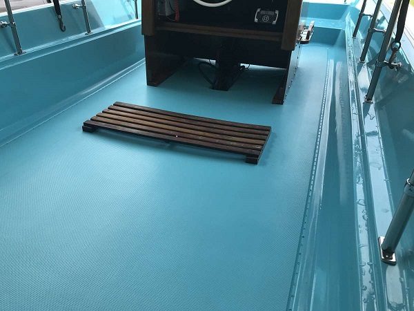

I do not recommend using bleach. Also, bleach does NOT kill mold. Remember that the non-skid and interior are gelcoat just like the outside and must be cared for and protected.
[MARY KATE ON-OFF] is about the most aggressive product I've used and almost always works. When it doesn't, I've found the only way to get deep stains in gelcoat is 1000 grit sand paper and then buff it out. For non skid, I've resorted to a stiff bristle brush with restorer wax or even compound when necessary. Don't forget the wax. Woody Wax for non-skid is expensive but I believe it's the best.
- 595-1200 resized.jpg (91.77 KiB) Viewed 23174 times

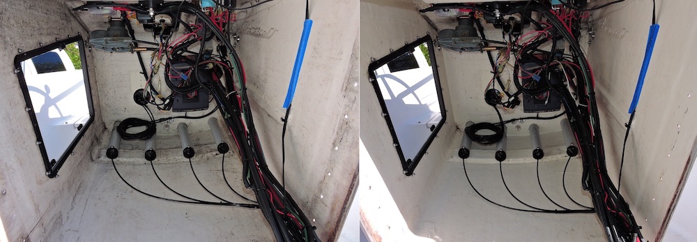

porthole wrote:Tilex Mold & Mildew - Root Penetrator.
Works great. Spray on, let sit a few minutes rinse off.
Found a picture of my 17 Outrage console when I cleaned it. This is one application of the Tilex with no brushing. Spray on, let sit, rinse off.
