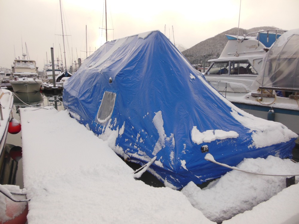

Enjoy it while you can!
We had almost 3-feet of beautiful powder in November. Temperatures between 5F and 25F. Easy shoveling, easy bike rides to work, just wonderful.
Then came December with record high temperatures, got to 58F at the house last week, records all over Juneau, 4-days of temperatures in the 50s. Rain. Including 1.6" of rain this past Fri/Sat and 2.3" at the house Sun/Mon. All the snow is gone.

- "The WILBUR" under cover.
- 20171118 110.JPG (216.56 KiB) Viewed 12361 times
