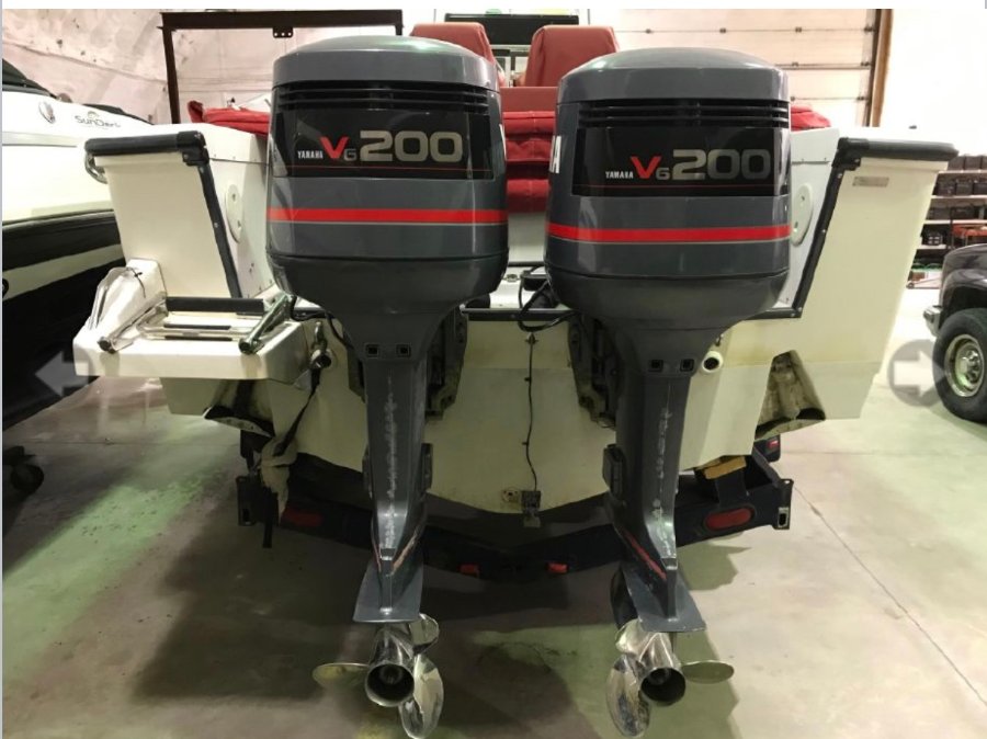

Happily, Chuck - Apologies that i missed your request - will post photos whenever I get her in the water!
She is powered with V6 two stroke engines:
