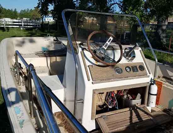

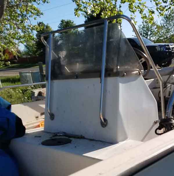

The console (picture above) looks fairly standard, but there is something strange attached to it on the forward face. I am not sure what you have there.
jstahlman
Posts: 21
Joined: Mon May 07, 2018 11:33 am
Re: Buying 17-footer; Interpreting HIN; Evinrude 115
Postby jstahlman » Wed May 09, 2018 9:28 am
I'm not sure, either, [if] the part in front has a fuel tank located under it. Basically it doubles as a seat. Until I get it apart I won't know if it was purchased that way or the front was added. If it was added they did a nice job. In the end I got both boats for $2,200. I have some work ahead: we will see if I am smart or a moron.
