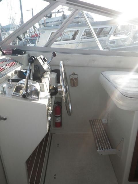

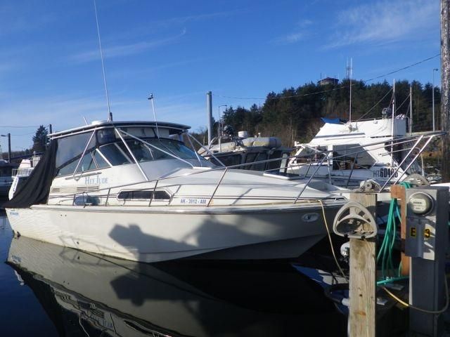

I'm still working on buying a 1990 Boston Whaler 31 (in previous discussions here) with twin 300 HP Cummins diesels. In the picture below, just forward of the black knobbed clutches on the port side of the helm are two "T-handles" that I've always referred to as "emergency shut-offs" for the diesels. They were on my Dad's 42' Post with diesels (Dad's T-handles were labeled "Diesel Emergency Shut-off") and I've seen the T-handles on other diesel boats. Aboard the 31 I'm looking at the owner's rep stated they are trolling valves for the engines/transmissions. Pull them out and the boat can be slowed to 2 knots on one engine (salmon trolling speed).
Any of you guys know what these T-handles are?

The diesel boats I've had experience with would make me guess fuel shut offs. Turning the key off on the diesels I've run didn't shut the fuel off or shut the engine down. Had to pull on a T handle hooked to a cable that went to the fuel injection pump.

Diesel emergency shut-off controls often consist of a pull handle, control cable and air or butterfly valve to shut off the combustion air supply to the engine. The advantage of the mechanical shut-off system is low cost, low maintenance, and high reliability.
The handles pictured could be either shut-off valve control handles or trolling control handles. If the controls are for air shut off it is usually easy to see the linkage connected to the cable on the air intake system. They are often located very early downstream of the air cleaner or silencer. If the controls are not for engine shut-off the probable purpose is to control trolling valves.
A Cummins dealer of technician should be able to supply an answer if you can't look at the boat.

Can you follow the cables? If they go to the trans they are most likely trolling valves. Trolling valves will be on the trans, most likely near the top. They allow the clutches to slip lowering your travel speed at idle.
Fuel shutoffs usually are 1/4 turn valves.
The T handles on your Dad's Post, up on the helm, were no doubt EMERGENCY shut downs for Detroit 2 strokes, Depending on the year, he most likely had one of the several variations of the 6-71 series. They were "doors" that slammed shut on the blower in an emergency shut down procedure. They were not designed to normally shut down the engine. But they were a matter of necessity on a completely mechanically controlled diesel.
Older boats with mechanical fuel systems could also have cables running to the injection pumps, shutting down the fuel.

Two Stroke Detroits were known to suffer "run away" so many had shut-off controls as porthole describes. Shut-off controls are less likely to be associated with four stroke diesel such as Cummins. Many shut off controls have red handles.

Good tidbit on the 2-stroke diesel vs 4-stroke.
So with the Cummins, they may have trolling valves, but no emergency shut-offs.

Those would have been trolling valves going to the ZF transmissions on the 6BTA5.9. (I had a pair of those engines for several years.) I would not expect those engines to have shut offs. --- And for the record shut-off valves aren't a bad thing. I have actually had a small Yanmar not shut off and ended up "dieseling" for an hour or so, just slowly burning fuel left in the lines (fuel was shut off).
