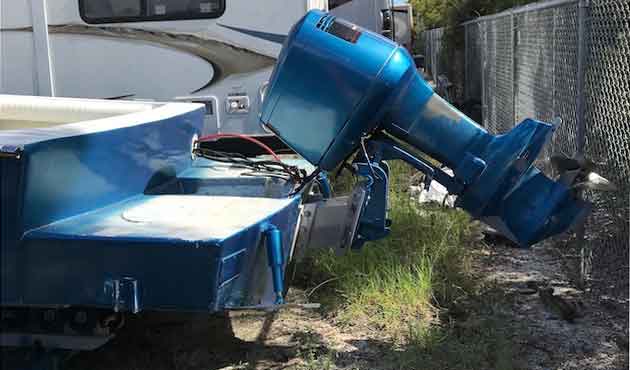

Hi everyone. I am looking for information on a [c.1977] 22-foot HI-LINER model I own. This boat has an aluminum [outboard engine bracket]. In old forum posts from ten years ago [c.2008] there was discussion about [YANKEE VOYAGER or HI-LINER models], including this same boat.
I am trying to find out if this boat came with this aluminum [engine setback bracket] or if it was a sterndrive. The transom is a full transom. The guy I bought it from knows very little about the history of the boat. I was told there were only three of this configuration ever built.
Any further information would be appreciated--Michael.

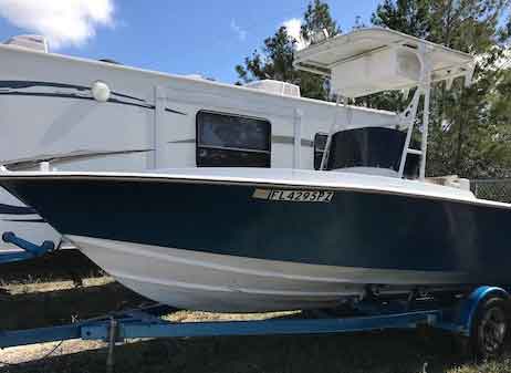

Bow of boat
Stern of boat

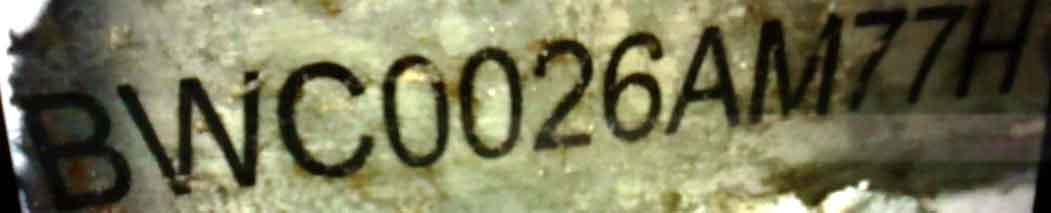

Hull Identification Number
Here is the HIN number off the boat

Re the image of the HIN--that looks a bit unusual. The HIN on a c.1977 Boston Whaler would have most likely have been an embossed metal tag riveted to the transom. The HIN in the picture looks nothing like that. If an embossed metal was not used, then the HIN was molded into the hull. The HIN seen in the image looks like it was printed. Also, it would be astonishing for the lettering to be so clear and distinct after the boat has been exposed to the sea and the weather for 41-years. Also the lettering appears to have proportional character spacing. Such lettering was unheard of in 1977. My opinion is the HIN label may not be an original work of Boston Whaler but some sort of reprint or added-later identification tag.

I believe Hull ID Numbers were not required prior to 1972, after which they were required to be molded in as part of the hull. [Note: no, embossed metal tags were initially used--jimh] So if the hull does not have the numbers molded into the stern it may be the hull is prior to 1972. My boat did not have the molded insert as it was a 1970 according to registration.
As Jim noted, the numbers look suspect. I'd recommend you follow up with some of those resources in that old thread.

I'm trying to figure out where this aluminum [engine set back bracket] comes into the picture. Everything I've read [about real Boston Whaler WHALER DRIVES] says they were [made] in the 1980's and made of fiberglass.
I'm calling Boston Whaler to see if they can help in figuring out what the original configuration was. I do know it was a cream color boat. Just can't see someone making an aluminum [engine set back bracket] for [this HI-LINER boat] if there were fiberglass ones available. Or [maybe] it was a prototype. I'll let you guys know what I find out-- Michael

The engine set back bracket on the HI-LINER being discussed in this thread is not a Whaler Drive. A Whaler Drive is a very specific sort of transom extension, with a very unusual design. It has air vents to permit the flow of water under the Whaler Drive to become aerated. It has very large through-bolt mountings. It has a very big buoyancy box design. It has a deep splash well with overboard drains. Whaler Drives were not made out of aluminum and bolted to fiberglass hulls.
The transom bracket on your boat looks nothing like a Whaler Drive. Please stop calling the engine set back bracket added to the HI-LINER you have a "Whaler Drive."

I was calling the bracket a "Whaler Drive" because that was what I believed it to be, although I have now found that it is not.

Now I am off to research Hi-Liners to see if I can figure out what I have. At this point I don't even know the year of manufacture because the Hull Identification Number [HIN] is bogus.

I think you were defrauded by the seller. If the HIN on the boat is a complete fabrication, and you paid more than a few hundred dollars for the boat, you ought to consider taking legal action against the seller. He committed a fraud when he sold you the boat.
You bought what you thought was a Boston Whaler boat based on the HIN. It's like a crook selling a fake Rolex watch. Someone invented that HIN and applied it to the boat. That is a fraudulent act.

Looks like someone got a little paint happy when it was sprayed. The person who fixed it up at least could have draped a sheet over the trailer, it takes no time at all.
In several of the pics it looks like the solid transom was an afterthought and they may have covered up a notched transom for an outboard. I do see irregular lines on the port part of the transom radius.
