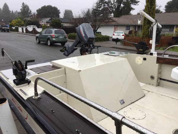

Fig. 1 No caption provided

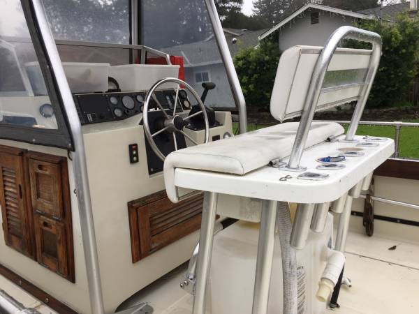

Fig. 2. No caption provided

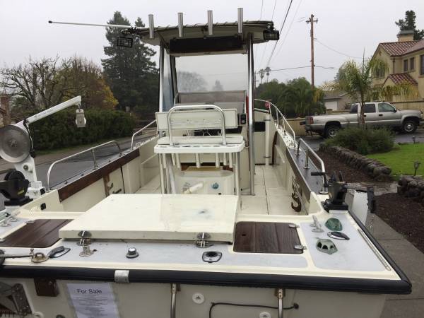

Fig. 3. No caption provided

The presence of that T-Top will tend to reduce performance from these calculations. Also, I don't think Boston Whaler ever offered a factory option of a T-Top, so the presumption I would make is that T-Top on this boat was added after it left the factory.

--this particular boat has the Super Console, which some think is an advantage compared to the much narrower standard console; others think the console is too wide and impedes movement fore and aft in the cockpit. It is really a matter of personal preference.

Also I was just sent a pic of the engine and the compartment is flush with the deck. There is no dam around it to funnel rain water or other out the drain holes. There is a huge void in the stern that can fill up with water so one is at the mercy of pumps. Not for me!
