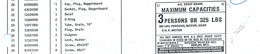

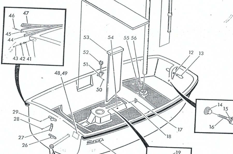

Not the best answer for your wood-in-the-transom question, but back in 2002 I asked Boston Whaler's Chuck Bennett for any plans he had on the Squall as I had picked up a waterlogged 1968 rowing model (Cetacea page 67). He sent me what he had, mostly sail plans and how to convert a rowing Squall to a sailing Squall.
Fig. 1
Fig. 2.
I just dug them out, and no wood locating diagram, but some other drawings that may be useful. I'd guess that there is plywood in the transom at least in the attachment points for the gudgeons and rudder lock (Fig. 1 at callouts 26 and 27). Other information in the drawings call for wood screws. Also a possibility, at callout 17 the downhaul cleat.
Another interesting feature to many of the drawing is that they were approved by the initials "RJD" - Bob Dougherty.
JimP
Re: Water in Hull
Posted: Wed Apr 15, 2020 12:46 pm
by biggiefl
That diagram is for a second generation Squall. The original Squall had a retractable keel, built in oarlocks, a rudder attachment, decals at the bow, and was rated for 5-HP. Due to manufacturing cost they really cheapened up the Squall in c.1980 and after. I wonder if the weight of post-1980 boats is different.
I have an original Squall sitting in my shop that is dry.
