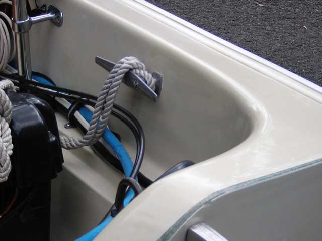

I added small stern cleats to my 1976 SPORT 15, mounting them on the inwale near the transom. I used them to attach a fender--there was no good place to attach a fender at the stern quarter--and for holding mooring lines for very short tie-ups in protected water. I didn't feel the cleats would be strong enough to hold mooring lines in a storm or rough seas. For strong mooring lines I used the stern towing-lifting eyes that are through-transom.
Fig. 1. Cleats add to inwale of SPORT 15 near stern. They were intentionally NOT mounted
to the top of the gunwale so they would
not snag lines or interfere with stepping aboard.
If you install cleats, they should be fastened into a part of the hull with embedded wood reinforcement. For my installation I was guided by the wood locating diagram for my hull. You can find similar diagrams for the 13-foot hull in the REFERENCE article for the 13-foot hull.
