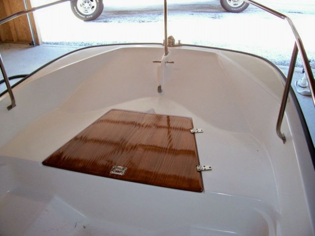

Here is good photo-image of how the newer Bow Rail on the c.1997 and newer MONTAUK is attached to the inwale instead of running vertically down to the cockpit deck:
http://www.whalercentral.com/images/ppimages/11300/pp3.jpg
The image is hosted at Joe Kris' fine WHALERCENTRAL website, but the photographer gave a link to it in a old forum post here on CONTINUOUSWAVE, which is how I happened to stumble across it this afternoon while browsing an old thread.
As seen in the above linked image, the vertical stanchions aft of the bow are actually bent in a very small radius bend to face outward and apparently have a flange or some other sort of rail base attached to permit the stanchion to be secured to the inwale of the hull in the raised deck area of the forward cockpit. I don't know if the mounting flange is welded to the stanchion. Maybe a reader with this style bow rail on their MONTAUK 17 can give us more information.

The [MONTAUK bow rail] depicted in the WhalerCentral photo is mine. All rail connection plates are welded to both the bow and side rails.
Posts: 13290
Re: Sources for 1997 Montauk 17 Bow Rail
Postby jimh » Tue Jun 30, 2020 8:38 am
lrb59--thanks for the information that the stanchion is welded to the flange or base plate. Your MONTAUK 17 boat looks fabulously clean and shiny.
