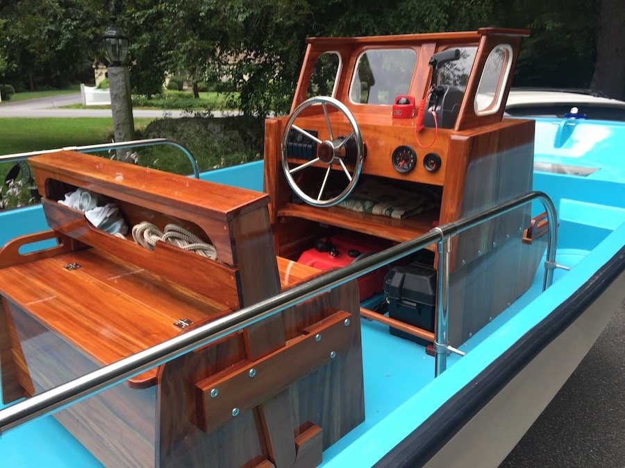

Summer and Fall 2019: Exterior and interior painted with help from Jamestown Distributers. I installed a new rub rail and reinstalling the stainless steel aft railings. The fall was spent on the center console and RPS. I had plans from Ward Grafton and initially planed to build the console and RPS from scratch. I ended up going with the kit from Specialty Marine. The kit saved quite a few dollars over the finished units but increased the time spent with fabrication and finishing.

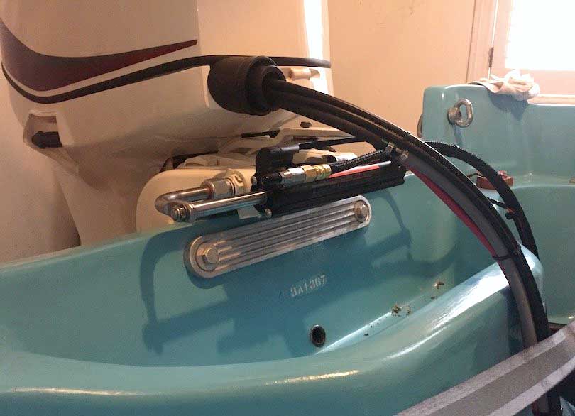

Summer 2020: Installed the console and RPS, wiring, new steering and engine installation. I showed the dealer how to angle the bottom bolts as per the Evinrude Service Bulletin but ended up with blind lag screws. Who knows how that story will end? I located the fuel and battery under center console. A new trailer and a bimini are planned for next year.

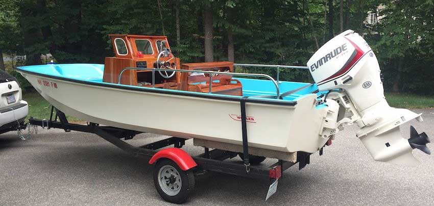

Fig. 1. E-TEC mounting plate

FIg. 2. SAKONNET cockpit
Sakonnet Cockpit.jpg (141.24 KiB) Viewed 3730 times
Fig. 3. SAKONNET on trailer

What brand and model number hydraulic steering did you install?
