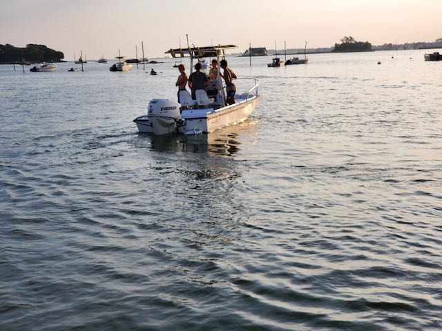

I considered the ball scuppers, but the water line is well above the scuppers. There is probably about 6" between the water line and the top of the transom where the engine mounts. I drilled a hole in the base of the transom and water wept out but nothing significant. The bilge is located forward of the helm under the seat in front of the helm and pumps a lot of water when water coming in through scuppers and into boat.

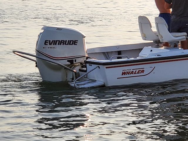

I have a few pics of the boat in the water, but I'm concerned about putting it back in. It is disconcerting when water is pouring in.
- 20200719_190655.jpeg (58.28 KiB) Viewed 8756 times
- 20200719_190734.jpeg (79.14 KiB) Viewed 8756 times
- 20200719_190744.jpeg (74.25 KiB) Viewed 8756 times

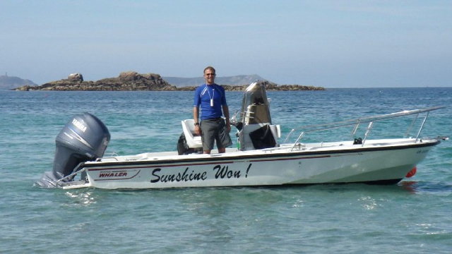

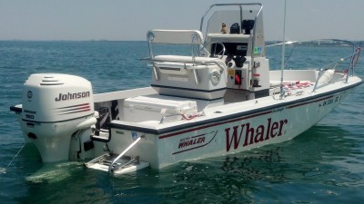

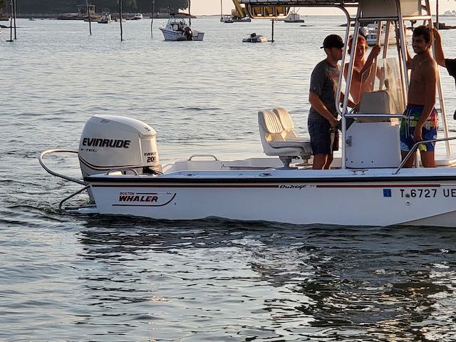

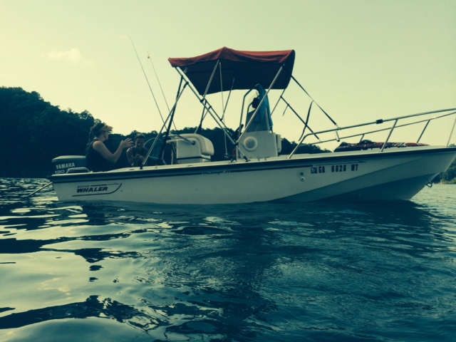

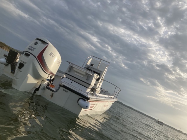

Here are a few photos of other Outrage 19's showing stern position.
Note the waterline in relation to the Boston Whaler logo.

My advice is to insert the drain plugs on the inside of all of the deck and splashwell drains and relaunch the boat.
Measure the waterline in relation to the Whaler logo.
While this model has the same hull design as the "classic" Outrage 18, it is 500 lbs heavier due to the additon of the floor liner, moulded livewell/seats and larger moulded/hinged console and aft seating suround. These additions resulted in a lower clearance of the top of the transom and the static waterline as shown in the photos above.
I had this same concern with my 1991 Outrage 17 due to a very heavy engine.
Shifting weight from the stern and plugging the drain tubes will minimize the stern down attitude.

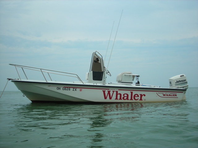

Re: 1994 Outrage 19'- High waterline
OUTRAGE 19 II underway
Here is another example of the waterline on a c.1992 Outrage 19 II with a 150-HP two-stroke-power-cycle engine.
