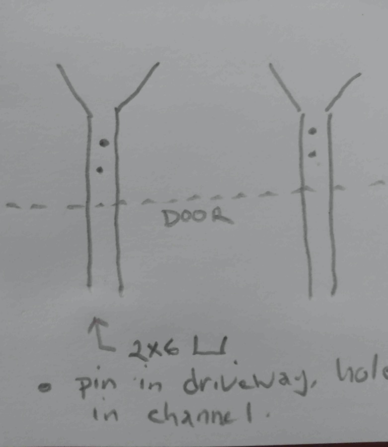

There was an owner out West, maybe Colorado, who had a hum-dinger of a sloped driveway. It was really, really steep. This feedback comes as a result of that conversation.
Look into marking lines on the driveway (like airport tarmac) to help you guide the trailer/truck.
You could place install temporary channels on the ground that would guide the trailer wheels to the correct orientation to clear the door.
Some supermarket parking lots have them for the cart return. Same idea.
These would be removable. All DIY, maybe $50 in materials.If you want more design details, I will post them.

I like the car wash tire guide idea.
