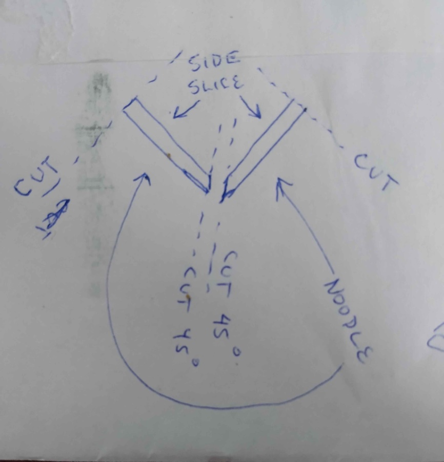

Most pad the corners for the tarp.
I bought a pool noodle,
For each corner:
Cut two (2) pieces that are 1 foot long.
Cut one end of each at a 45 angle.
Position both so they form a 90 degree.
Slice each on the inside wall, [half] way through.
Install on corner, stretching them over the rub rail
Install tarp.

By reading, I can't picture exactly how you did it, sorry. Do you have any pic on hand to post it here?

Here is a quick sketch.
- noodle.jpg (93.83 KiB) Viewed 5698 times

I may have some of the pipe foam insulation on my shelves. I understand about the cutting across 90 and 45 degrees.
What I am not clear is: "Slice each on the inside wall, [half] way through". What do you mean by "[half] way through". Do you slide and cut the tube into half, along the length? How does it stay on? Do you have to use glue to keep it on?

Once you pull it open like a C you can see if it will stay on by itself.
Given the size of the corner hardware, I will guess it will NOT stay on by inself.
I would attach the tarp and bungie it down and then attach the noodles. The tarp will hold them in place.
