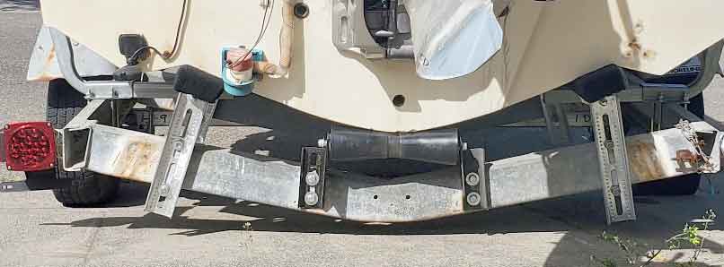

Fig. 1. Clearance at exit of driveway.
Fig. 2. View of underside of trailer.

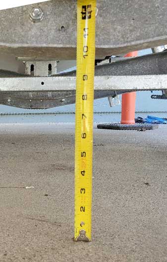

Fig. 3. Clearance between rear cross member of trailer and ground.

It is difficult to assess the ground clearance shown in Figure 1 because the camera is shooting downward. The clearance does look rather close.

In Figure 3 there appears to be about 10-inches clearance between the road and the bottom of the rear cross member of the trailer. I assume that when this was measured the trailer frame was aligned to be level with the ground.

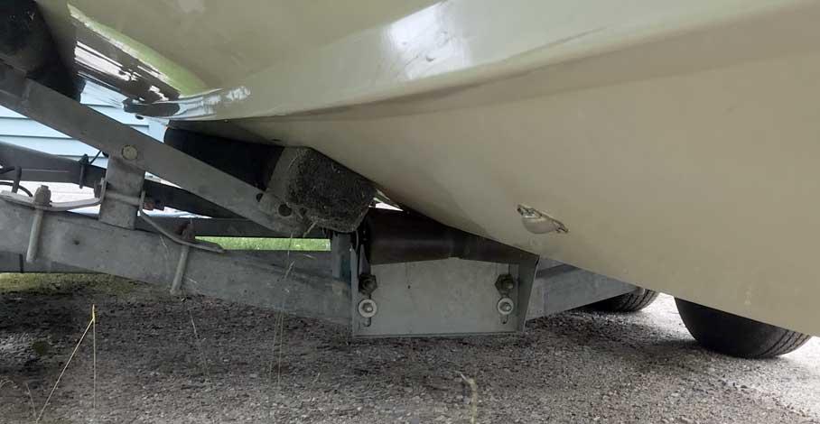

Fig. 4. Trailer clearance. The lowest object on my boat trailer is the bottom edge of the keel roller brackets. In this view I would guess there is about 10-inches clearance, at most.

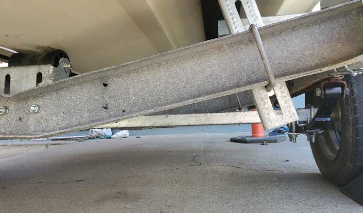

Fig. 5. There is 7-inches of clearance at the lowest part of the trailer when level with pavement.
The mechanics still are uncertain about raising the springs above the axle.
I am not sure how to proceed.

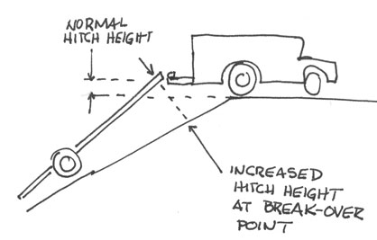

Phil T wrote:With a small break-over-angle, the boat transom may make contact with the ground when traveling over a...ramp head (area of transition from flat grade to ramp grade)
I am sure that is how I lost the license plate on my trailer. The ramp I use now has a very sharp break over from flat to down-slope. Also, with my towing vehicle, the distance between the rear ties and the hitch ball is several feet. That long distance exacerbates the effective rise of the trailer hitch when transiting the break-over.
Fig. 6. A an exaggerated sketch showing how the effective height of the towing car hitch increases when transiting a sharp break-over angle from incline to flat pavement.
Note in Figure 6 above how the distance from the tow vehicle rear axle to the hitch ball increases the effect of the break-over angle on increase in effective hitch height.
