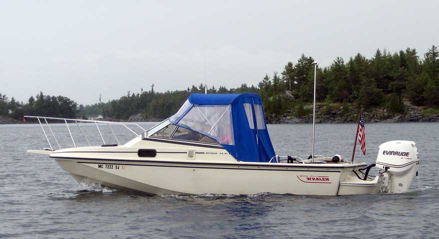

Our REVENGE 22 W-T Whaler Drive boat has a drop curtain. We often leave the drop curtain in place while underway on rainy days.
Fig. 1. Weather canvas system by Wm. J. Mills & Co. for a REVENGE 22 W-T. Here the boat is underway on a cold and rainy day on Georgian Bay in July, 2009. Photo credit Dave B.
The weather canvas system seen in Figure 1 has five parts:
  • Flying Top
  • Windshield
  • Port side curtain
  • Starboard side curtain
  • Aft drop curtain
. The joints between canvas sections are made with zippers. The joints between canvas and boat are snaps. The lower edge of the drop curtain is kept in tension by small bungee cords that pull outward and downward on the outer lower corners of the curtain. This imparts tension on the zipper joint, so the zipper operates smoothly in either direction. In the illustration above the lower part of the drop curtain is unzippered and open so that there can be some air flow through the enclosed helm space.
The Wm. J. Mills & Co. have stock patterns for many classic Boston Whaler boats. I don't know if they have any patterns for Boston Whaler Commercial and Government Products boats. If you contact them, tell them you hear about their canvas for Boston Whaler boats on CONTINUOUSWAVE.COM.
