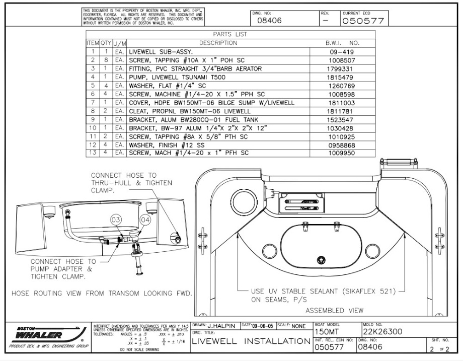

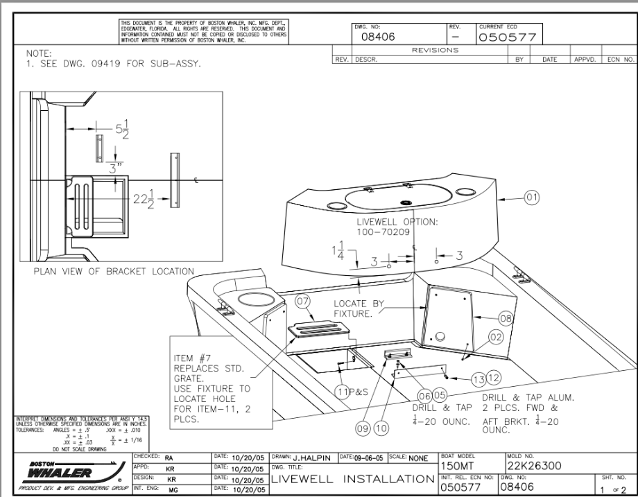

From reviewing the website and the reference diagrams, it does appear the current livewell option is compatable with the 2010 Montauk 150.
For confirmation and pricing, contact your local dealer. For superior service and support, I would contact either Sue Lodel at Twin Cities Marine or Justin at Nauset Marine.
http://www.beacontcm.com
http://www.nausetmarine.com
For reference:
2022 Livewell available from a local dealer.
2010 Livewell option - technical drawings
